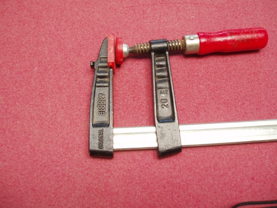

I have six Bessey F-clamps with the thick steel bars but no clutch. With genuine respect to those who are struggling with them, I found them easy and intuitive to use. Here are "tricks" that help me:
* RULE #1: Whenever you use the clamp, always make sure there are visible threads showing on the tip side of the moveable jaw's screw so that you can always unscrew the clamp. If you leave no threads on the clamp side of the moveable jaw, then you will struggle to unscrew or loosen the clamp.
* When I put them away, I always roughly "center" the clamp screw in the moveable jaw first, then store them clamped. I leave it so that there are screw threads visible on both sides of the screw. You want to be sure the screw has room to turn. Then I shove the moveable jaw against the fixed jaw to "clamp" it so it stays there.
* When using the clamps, make sure that you leave visible threads to unscrew the clamp. If there is a problem, back off the clamp, give yourself some more threads, and reclamp.
* To release the clamp, I give the screw a few turns to loosen it and make space for the moveable jaw. Next, tip the moveable jaw in towards the fixed jaw to unhook the moveable jaw from the "teeth" on the bar. While the moveable part is tipped towards the fixed jaw, slide the moveable jaw up or down the bar. Do not apply a lot of pressure when tipping the moveable jaw towards the fixed jaw. If you apply too much "tilt pressure", the moveable jaw may scrape the bar teeth or bind slightly.
Reminder: If you did not leave extra threads to unscrew and loosen the clamp, then you will struggle.
Photos:
(a) Stored - How I store them.
(b) Open - This is the gap that's needed to fully tilt the moveable jaw into the fixed jaw. The moveable jaw will not slide on the bar in this position. You do not need this much gap to tilt and release the jaw, but any extra gap beyond this won't help more.
(c) Tilted Jaw - This is the moveable jaw tilted towards the fixed jaw from the previous position shown in photo "b". The moveable jaw will slide up and down the bar when tilted this way. (The tilt is not much, but it makes the difference.)
For the record, I am asking myself whether this post will help or not. I hope it helps some of those who are struggling with those Bessey clamps. For the record, they are my favorite clamps. All of my other clamps are cheap or old.

Photos:
View attachment 3925091 View attachment 3925092 View attachment 3925093
