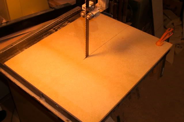

13609 posts in 3369 days
#10 posted 07-10-2010 02:20 PM
lis ,
when cutting small pieces ,
i mount a smooth board on the table of the saw ,
(clamp , double tape , or slide in with stops ) ,
come straight in front to back ,
that way you don’t lose those tiny pieces in the hole ,
just widen slightly up to the cut line ,
it fills up with sawdust , and is hard to get back off .
it’s all in the quality of the blade ,
those tin blades are almost worthless .
this is all i can find , i hope it helps
they start at 5’ , 1/4” longer than yours ,
shouldn’t be a problem .
g’luck !
http://www.bibbtool.com/bandsaw_blades.php?gclid=CPfozNP34KICFRAeDQodA0i6aQ
View tyskkvinna's profile
tyskkvinna
1310 posts in 3014 days
#11 posted 07-10-2010 03:03 PM
If I get a new blade for it, what size should I get? It looks like Woodcraft has them in 1/8, 1/4 and 1/2.
It wasn’t really an impulse buy, but this was the last push over the edge.
I was using my coping saw – which I’m fairly adept with – and was just getting frustrated.
David – I was thinking of making something like that, as one of my first test pieces, flew down inside!
-- Lis - Michigan - http://www.missmooseart.com - https://www.etsy.com/people/lisbokt
View Sheila Landry (scrollgirl)'s profile
9231 posts in 2948 days
#12 posted 07-10-2010 03:11 PM
I would love to see if you make something like David was talking about – or pictures from David (hint, hint!) I was thinking the same thing: that the small pieces would get lost. Please keep us posted on what you do.
Sheila
-- Designer/Artist/Teacher. Owner of Sheila Landry Designs (http://www.sheilalandrydesigns.com) Scroll saw, wood working and painting patterns and surfaces. "Knowledge is Power"
#13 posted 07-10-2010 03:36 PM
for tighter curves ,
1/8” or 3/16” .
the wider the blade ,
the bugger the radius .
here it is ,
this one is clamped to the table ,
it could have stops under it ,
at the edges ,
so you just slide it in ,
remember to make the slot slightly wider ,
so you can get it of later ,
(you can run a flat screwdriver backwards to clean it out
as it likes to fill with sawdust ,
and pulling it back off ,
can make the blade come forward off the wheels
