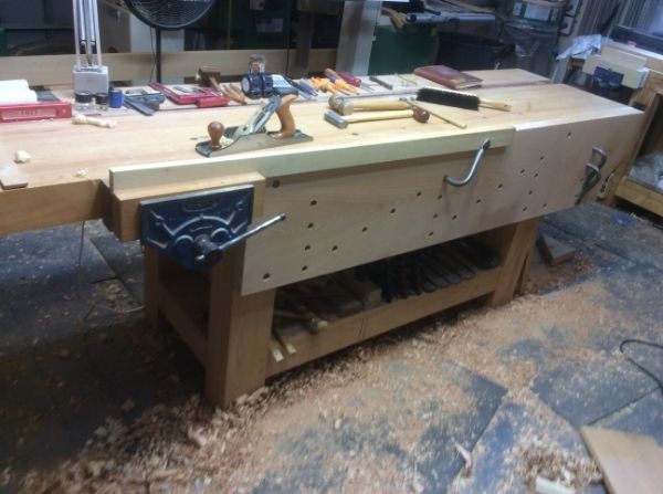

This is the latest made from European Beech with a English QR vise that I’ve used since the 70’s, no tail or wagon vise, and an English style apron. It is near perfect for my work and was built in less than two months while working full time at the day job and keeping MsBubba happy:
