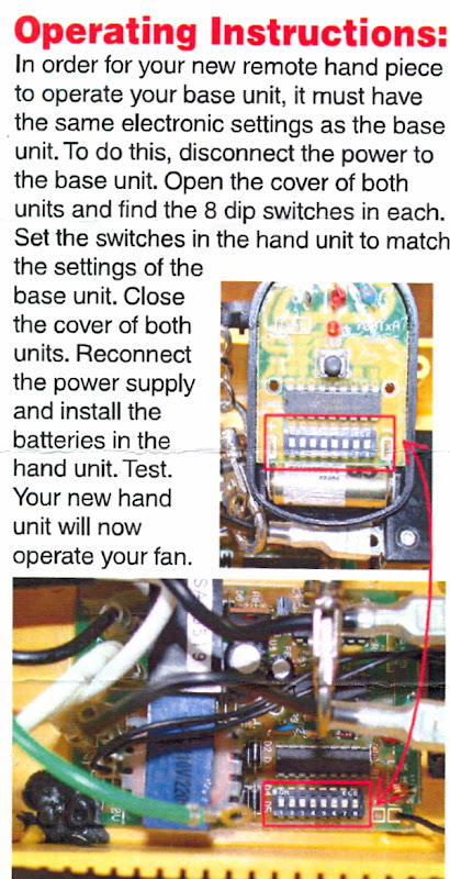

Hi Bob, I have read this article with a smile on my face – we only get 2 types of service here – extremely good service or NO service, bad service would be welcomed in lieu of NO service.
In defence of the company selling the product – the remote and the main unit are paired, so that they operate with the correct coding/Chanel (depending how it is configured). However these are usually “DIP” Switch selectable, so that if you have another remote (different appliance operating on the same channel/coding), you can change the channel coding to avoid co-interference – otherwise you TV controller may start your dust collector when you change the channel.
So that their excuse that remotes are paired is correct, but what happens when they get a fault with a remote, do they change the whole package? And yes so many companies today employ people with no education, No motivation, and No Loyalty to the company – they are just McJobs and McEmployees

I believe there is a “regulator body” over here that sets the frequencies that varous signals are allowed to use in their transmitters.
The result is that telephones, radios, cell phones and garage door openers etc. all are restricted to a specific range of frequency.
In the case of these transmitters, according to Woodcraft the keypad will activate either the 110 volt system or the 220 volt system suggesting that they have chosen a standard frequency for these units.

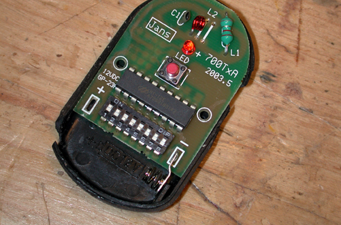

Out of curiosity, I opened my remote, which is identical to the ones pictured here. As mentioned earlier, there is a set of eight DIP switches. Of course, to get the new one to work, you will have to set the switches to be the same as on the old remote. If that one is damaged beyond recognition, you might have to open the receiver.

I haven’t read this entire thread so forgive me if this has been suggested already, but especially given what Chuck just said, in operating theory at least, these things are nothing more than a variation on the garage door opener. Setting the DIP switches as he suggests should do the trick, assuming there has been no design change from the time your receiver was made to the production of the replacement remote.

Chuck, thanks for the tip . If that’s the case I am golden!
Way over the abilities of customer service I guess.
Can you imagine tossing out your TV set because your kid dropped the channel changer in the toilet?

At DanM ’s suggestion I went to the shop tonight to round up the broken pieces of the keypad switch and check for dip switches.
Sure enough they we there!
I soldered the battery terminal back on the circuit board and voila it still runs!
I am finding enough of the case to get the c/boards covered and will just tape it over to keep the dust out.
Now when my new one arrives I’ll just have to set it the same as these dip switches if it it’s not already set that way and I will have two switches.
From shop pics 2009

Bob I wish you luck, but if the remotes use different protocols, then you might find that they are incompatible.
With regard to the manufacturers comment “Unfortunately we do not have the remotes separately since they are programmed and supplied with the switch.” Why oh Why to manufacturers think that ALL customers are MORONS like the McStaff that they employ – how difficult would it be to provide a simple instruction on how to set the Dip switch settings on the remote. This manufacturer definitely gets the “Thumbs Down” from me with regard to Service and Customer satisfaction.

Another thought just came to mind – The Radio frequency used is controlled by the government or some official body – but the protocol-coding used is up to the manufacturer. What happens if you buy two units, or your (not very friendly) neighbour has one, and they are on the same channel/coding – they must provide some instruction as how to alter the “paired coding” so not to cause interference to other users.

Tony, over here many remote switches are sold with 2 keypads and with garage door openers you can get one for the whole family if you choose.
I think the problem with interference with other receivers is dealt with by the distance between receivers ( ie over x number of meters)
There are 8 switches on the key pad so I presume a different combination of setting would work on a different frequency.
(I’m guessing but it’s not Rocket surgery;-0 )
I would have appreciated a note and diagram from the manufacturer but we live in strange times.
I could walk to the DC and turn it on and off but it really interferes with my set ups when I have a series of tasks to do and don’t want the dc humming at me through the whole deal.
All I know is that lots of appliances have remotes today and the problem of interference seems minimal or non existent.

The systems can all operate on the same frequency. The DIP switch setting prevents your remote from controlling your neighbor’s DC and vice-versa – unless one of you is devious and patient enough to try all the 256 possible settings until you hit the right one.
These remotes work like the “second stage wireless garage door opener system” described here.

Normally the frequency is not changed – it is a broad band spread spectrum – but the data sent (coding) is changed, just like a digital lock, with the correct code it will operate.

Just a follow up on the remote key switch for this duct collector system.
I recieved my new switch today.
It’s identicle to the one I broke except that it contains instructions for setting the dip switches to match the base unit.
It would appear that Woodcraft was able to do their homework and not only provide point of sale for the units but also that little extra that separates good companies from the pack.
Incidently they use “Borderfree” to Canada which remove sthe hassel of the border and brings the goods in at about the same cost as shipping them within Canada.
Nice job Woodcraft! 5 stars*

This is exactly the simple thing that we were all talking about – it is not rocket science for the manufacturer to have undertaken this service.
You did not mention if it worked or not?

Looking abck on this fiasco it obvious that the manufacturer would not set up a world wide market for a product that required trained electonic technicians to maintain serviceability.
Common sense dictates that a simple dip switch system would be the most serviceable.
I can’t help but wonder if :
“A” the company I dealt with is not up to speed with technology .
“B” The company deliberately omits additional remotes to boost sales.
“C” They simply don’t care.
The problems is resolved for me as the remote works as suggested.
I posted this here to help other LJ’s tht might be duped into thinking that this could not be done. I also appreciate it when I ask someone a question that if they don’t have the correct answer that they don’t make one up.
A decent supplier would find out for his customer.
