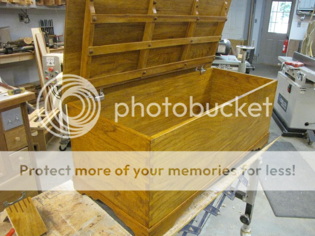

Below are a couple of photos of the chest I did out of Pecan:
