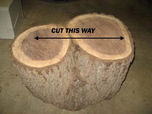

I have inherited a walnut stump from my late Grandfather. It was given to him by my Uncle about 25yrs ago. The stump is native to Missouri but has been in my Grandfathers garage in Denver for roughly 25yrs. This is my first experience with trying to get project wood from a stump so I don’t know much about the strategy of resawing it. The ends have not been sealed, as I see is recommended by many here. I hope the dry Colorado climate has kept it from being ruined by moisture. At first glance it looks OK…See below. I took these pics before I left Denver a few weeks ago, of course I left without measuring it. I estimate it is roughtly 20” x 20”. I will use my local hardwood shop to resaw it for me.
Thoughts, hints, suggestions on how to handle this stump? I’m excited about the procpects of making some small gifts for my father and his siblings out of this stump that belonged to thier dad…I’d be open to suggestions on what to do with the cut stock as well.
Thanks! Greg

I love walnut, How about bowls? Write a little story about it on a card and laminate it to the bottom so future generations can read about it.

I’d saw it across the crotch, so the crotch grain will show. It will make for some wild grain that is perfect for panels, and even gunstocks.

I’d have to say that if it was me, and it’s obviously not… you would get a few nice crotch slabs out of either side for say some small end tables or what not, and still have plenty of “heartwood” left to make gunstocks or whatever you wanted with that beautiful piece of wood.

oldskool…So, cuta couple of crotch slabs parrallel to the ground in this picture? Just making sure I understand your suggestion.

The last pic where the crotch splits off, I would cut the edges off a few inches thick, (they way your arrow indicates) and leave only the center wood, it would be like a thick slab left for whatever you desire. Of course this would leave the bark still on it, unless you take that off, but you could get more different types of projects out of this pieces that way. That’s just me though.

Have it cut straight down from the line in the picture so you’ve got a flat piece that shows both halves of the crotch. Then cut another slabs off etc. If you have a finished thickness in mind, cut it a little thicker than that, because all the internal stress in that section is going to make it react out of flat when you’re working on it.

I am picking back up on this…I will be getting the stump this weekend. I am in the humid mid west…this stump has spent the last 25yrs in dry climate Denver.
Do I need to let the stump sit for a while before I get it cut into slabs? And then after it is cut, should I let the slabs sit before using for projects? Or try to use it right away? I plan to have it cut into 4/4 slabs.

since your going 4/4 i guess your not going the bowl route.. after it’s cut i would anchor seal the ends and sticker it.. wood that old should be stable.. it will pcik up humidty. so just make sure it pciks it up on both sides
the people that cut it should have suggestions for your area
