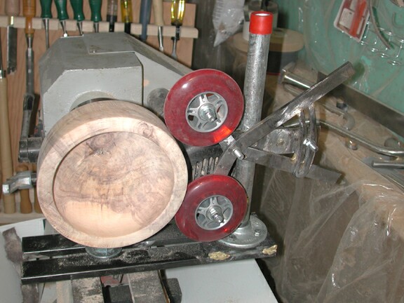

Is this the style you are looking for?
From wood stuff 2009
Oneway lathes sell a commercial version if you can’t make one yourself.
This style is often used ffor spindles too
