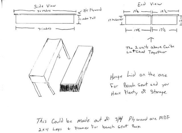

#5 posted 575 days ago
A cheap and easy way would be too build 2 platforms of equal sizes, the bases could be about 17 inches tall with a top 19 1/2 X 75 (each one is half a standard single bed size) The top shold hang over the base on the ends and one side. One half would be the bench if you hinge the top of this unit there would be plenty of storage under this. Wheels could be added to make them easy too move. For the desk top you could use fold out legs 26 to 30 inches long depending on the height you wanted. Both units could be latched together and you have a bed.
-- JohnShackleford,North Carolina

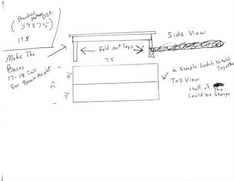

108 posts in 1252 days
#6 posted 574 days ago
here are some better pics to describe what I am talking about hope this helps.

#7 posted 574 days ago
Wow! It fits the criteria. Few materials, ease of construction and simplicity. Brilliant! Thanks! I’ve forwarded all of the proposals and have the two orphanage directors looking at them. I told them more could be coming. I’ll let you know how it goes. Exciting!

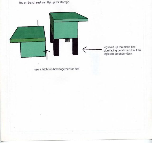

#8 posted 570 days ago
I have been learning sketch-up here is what I got so far ,still have a lot to learn with the program
