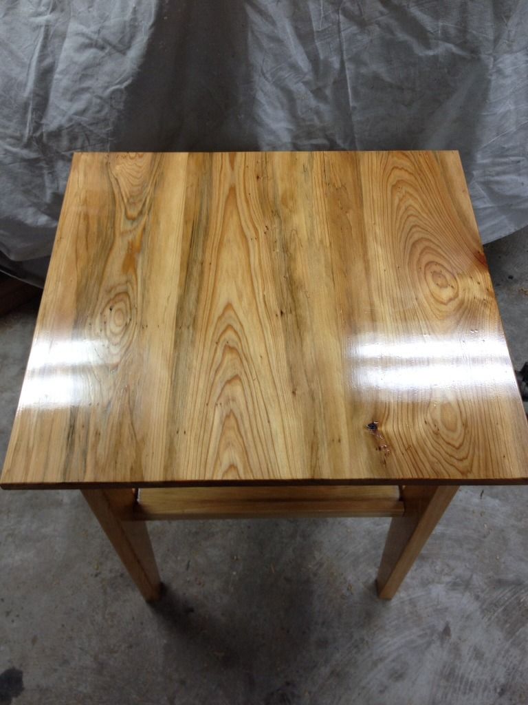

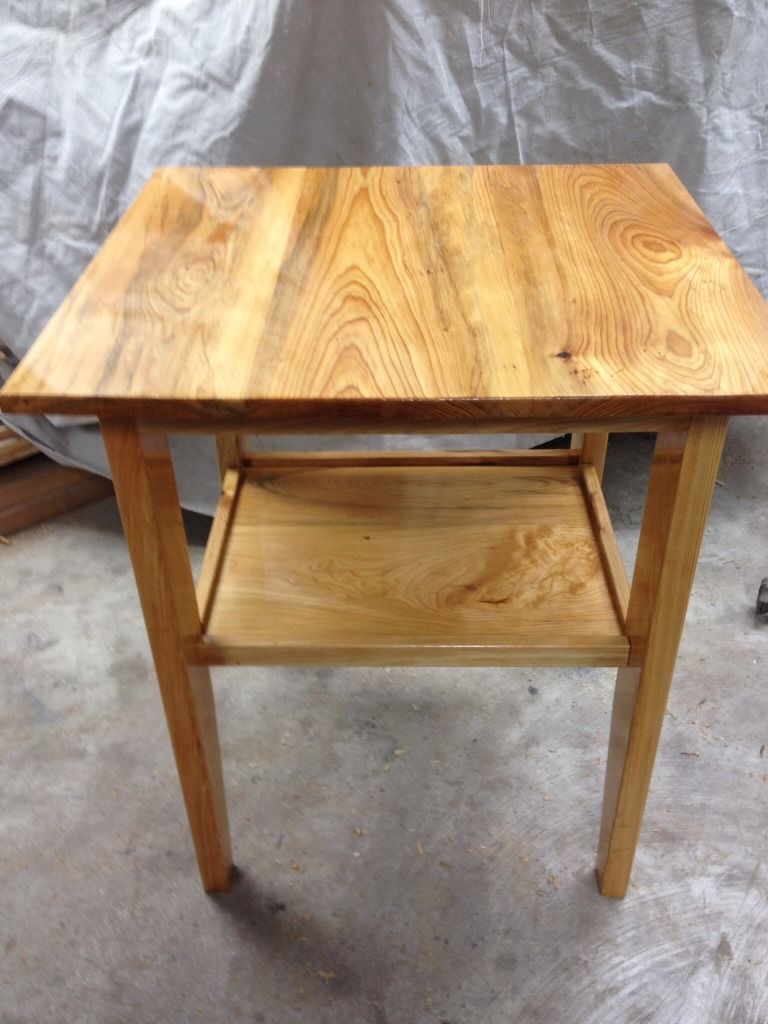

I had similar probs with a couple tables I did. So I used a cabinet scraper to knock down the high spots then hit it with 320 grit. This is how it came out. Just one of a billion ways.
