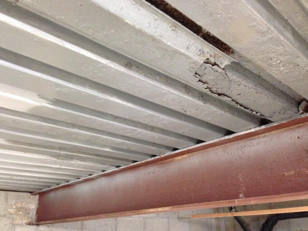

Hi Lumberjocks,
I’m having a problem with my shop ceiling. My shop is located in an unfinished room under my garage (connected by a stairway without a door.) It sits adjacent to my basement with a door connecting to the finished part of the basement, so the shop is below grade.
I’ve been woodworking a little over a year and a half, and have accumulated three tools with cast iron tables. Since the shop has no HVAC and thus no climate control, I’ve learned how to deal with rust (thanks to this forum) accumulating from condensation.
A bigger problem has developed this summer with it being so hot and humid I’m the Eastern US. My shop ceiling is made of some sort of corrugated metal that seems to be what they poured the concrete slab from the garage into during construction [please forgive my lack of understand of construction practices and terminology.] The slab is supported by I-beams as well.
What’s started to happen is the metal ceiling is corroding and starting to drip rust in a few spots, falling onto my tools and projects. This seems to have happened at some rate over the 10 years the house has been in existence, but it seems to be worse this year.
I’ve temporarily tried rust remover and spray painting the areas in question, but this is obviously not a long term solution. The ceilings are only about 7 feet high, so not a lot of wiggle room.
I’d like to come up with a longer term solution as I see myself continuing woodworking as a hobby for many years to come. I’d love to one day waterproof the shop and finish it, also with heating/cooling outfitted. But feel I need to deal with the rust issue ASAP.
Some options I thought of:
1) Finishing the concrete garage slab floor (above shop ceiling) with epoxy, thus creating a moisture barrier
2) Sanding the ceiling down to bare metal and applying some sort of barrier against rust
3) Having a contractor come look at removing the metal ceiling – I don’t believe it’s structural, but not sure
I’ll post some pictures to help explain. Any advice is much appreciated!

Hey there. I can tell you right off, I seriously doubt that you’ll be able to have the metal removed. That metal is probably what your slab is poured directly on. That is called pan decking and it is what concrete is usually poured on top of, so removing the metal is probably not really an option. In other words, it is structural.
That said, you could try the epoxy floor, but that sure is a lot of work unless you want to do it anyway.
This is what I would do – Get an angle grinder and put on some flap discs (sanding discs) and go around and sand all of the rusty spots and bubbly spots that look like they will rust. Get them down to bare metal and then spray them with cold galvanizing spraypaint. This spray is basically an after the fact galvanizing operation used on things like outdoor welds that would rust if not protected. Typically, the moisture is coming from the painted side, but in your case it sounds like it might be coming from above. So the paint might not work, but either way it is worth a shot and is easier than doing an epoxy floor. It might work, you’ll just have to give it a shot. Good Luck!!!

It would be expensive, but you can have two part foam insulation sprayed right over the metal as is, or you can clean some of the rust off a bit before having it sprayed. It would keep condensation from being able to form on the metal and wouldn’t add much dimension to the ceiling cutting down on your head room. Sanding the rust off the metal could be accomplished efficiently with a grit in the 60 – 80 area.

Do what oyster said. Clean the rust sots down to bare metal and repaint. The metal is serving as a moisture barrier, epoxy on the garage floor will do nothing for you other than a nice looking garage floor. Your moisture is coming up thru the floor and condensing on the ceiling. A dehumidifier or spray on insulation as suggested will be your best solutions to stop further moisture and rust after you clean and paint.

From a little bit of reading it seems that the high alkalyds (sp) in concrete contribute to the rusting of metals. Id be willing to bet that the existing decking that’s rusting in your shop is galvanized as well. You may want to make sure that any new product you use will bond with the galvanized metal.
