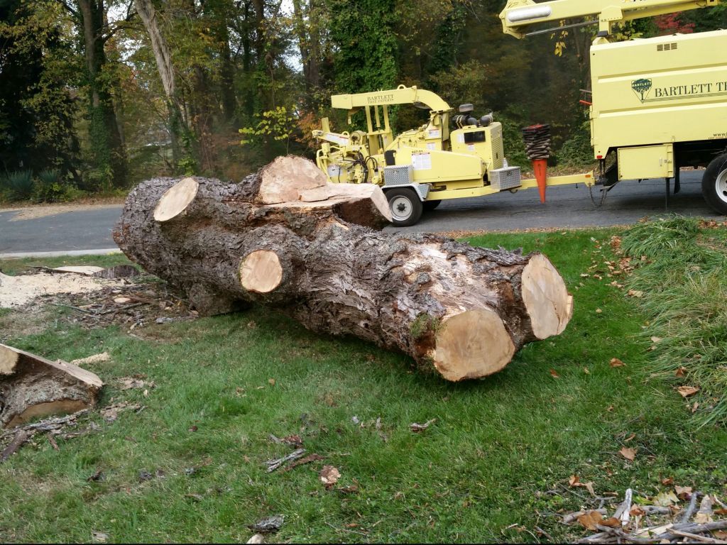

Well, folks, thanks again for your replies back in April. The maple came down today, and I got several logs over to a sawyer to try to get some useful lumber from what otherwise would have been destroyed or turned into firewood.
Now I have another dilemma: the bulk of the trunk still lies in my front yard, either to be sawed into about three-foot lengths and destroyed, or to be turned into slabs as Jesse Felling suggested immediately above. Several who saw the pictures felt that the tree was likely hollow, but it appears to be solid. And BIG.
I’ll attach pictures. At the lower end, the trunk is about 48” at the widest point, and about 38” on the shorter dimension. I’d estimate it to be about fourteen feet long, and again apparently solid throughout. It’s too big for my sawyer to work with, so I thought I’d see if any of you knew of anyone around central Virginia or nearby who might be interested in cutting it and sharing the wood.
I am of course open to other suggestions that you all might have.
—Mike Jernigan, Greensboro NC (though the tree is in Richmond, VA)

View firefighterontheside's profile
18351 posts in 1882 days
#8 posted 11-06-2014 02:25 AM
You can cut some of those crotches where the limbs used to be and make some turning blanks for you or someone else. Then with a chainsaw slab off three sides and make it fit into the mill.
-- Bill M. "People change, walnut doesn't" by Gene.

View EightOhMike's profile
EightOhMike
5 posts in 1520 days
#10 posted 11-06-2014 02:51 AM
Re: the couch:
At first I thought you were joking. Now I’m not so sure… but that would still be one BIG couch, with a bunch of waste. But I’ll bet it could be done. The pics auto-cropped, so it doesn’t seem to show just how big the thing is.
I have some smaller logs that I think I’ll keep as turning blanks, thanks to a suggestion from a guy at Woodcraft today. Have to figure out what shape I should make them, and how long they’d have to dry (different thread stuff, I presume).

I’ve cut a quasi wingback chair from a big chunk of an ash tree trunk, a couch from maple seems like a perfect idea. Sure there would be a lot of waste, but the chunk removed would be big enough itself to be milled. The other consideration is it could weigh over 2000lbs. after it was finished.

#12 posted 11-06-2014 03:45 AM
hey Mike,
Before too long goes by, seal the ends of the log and all cuts with anchor seal. This will slowdown the checking and cracking from the ends.
you might try the Woodmizer site for possible sawyers. Also a simple google search for “Sawmills richmond va” came up with a number of possibilities: link
Regarding timing, of you, your wife and your neighbors do not mind, you can leave it in your front yard for several months while you get a sawyer nailed down. My only suggestion is to get it off the grown by putting some sort of cribbing under the log. I think that this will reduce any rotting and infestation.
My guess is that you most likely don’t have the equipment to move that beast so it may not be possible. Perhaps an engine hoist could lift up end high enough so you could get some 4×4s under the log. Then move to the other end and repeat.
Are you air drying the lumber or is the sawyer going to dry it for you? Here is a link a recent post of mine where I described what I went through to set my recently cut log up for air drying. Perhaps this will help you.
Good luck and enjoy your lumber.

That tree would make some nice slabs. However, no woodmizer sawmill can saw one that big. You need a swing mill with a slabber, like a Lucas mill.
