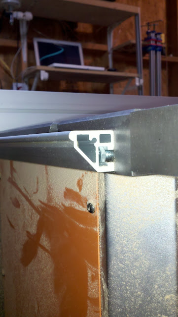

I spent most of the afternoon dismantling, cleaning, and re-assembly the TS. Everything went smoothly until I tried to put the rear fence rail back on. The rail didn’t match the drawing in the manual and couldn’t be attached the way it was described. After some head-scratching and research, I determined I have rails (front and back) from the newer Ridgid model R4512.
It’s pretty clear to me that someone did a little garage engineering to make this fit. Different fasteners, drilled out holes, the signs are there.
Here is a picture of the rear rail I have (R4512):
And here is a picture of a TS3650 rail from the internet. Incidently, this is from a blog where the user is putting TS3650 rails on his R4512:
Thanks to the previous owner and his handy drill, the new rail attaches to the table, but there are a few other problems I’ve discovered that are not so easily fixed.
Problems:
1) The new rail is taller and impedes on the miter slot. I could drill out the holes and allow the rail to sit lower, but that would cause further problems. Which leads us to the next problem.
2) The new rail impedes on the motor mount and keeps the blade from beveling to 45 degrees. I can only get 41 degrees of travel. Here is a picture of the splitter mount hitting the rail:
3) The new rails make the fence sit up off the table about 1/8th of an inch. This is obviously bad if you’re cutting thin stock.
I’m kicking my self for not picking up on these things, but they were clearly Ridgid rails on a Ridgid saw. They looked like they fit, and fence clamped down well. I guess that’s what you risk when dealing on CL.

So looking at the 2 pics it looks to me like if you flip your rail counter clockwise 90 you’ll have the same mounting that the 2nd pic shows. Why wouldn’t that work?
edit: remove the splitter mount. I assume you have another one inboard by the blade, make a splitter that uses that one alone.

1) Mod the aluminum rail with a small notch to get to 45 degrees.

Buy a new rear 3650 rail from m&d mower. The OEM fence on the 3650 is every bit as good was a t2, and it offer 6” more rip capacity. Also, if you are willing to sacrifice the usefulness of the front rail tape, and give up rip capacity to the left of the blade,the OEM rails of the 3650 can be slid to the right for upwards of 42” of rip capacity, and perhaps as much as 48” of rip capacity.

I have this saw and I like it. I bought mine in 2006. Well worth some fix-up work. You may be able to notch the rail as has been suggested, by Danger Dug, for the saw blade tilt issue. Also notch for the miter slot issue. You could add some material, either wood or metal, to the underside of your fence to make it touch the table saw top. If all this does not work as you like then look into replacing the rail with the right one as toolie suggested.

2. Buy a new rear rail, which a little research shows is available for around $55.
Personally, I’d just buy a new rail (unless a fellow LJ happens to have one lying around).

If you decide to go with cutting the current rail, another thing I’d do is enlarge the current mounting holes so the fence can sit lower. I like my fence about 1/16” above the table so I can cut 1/8” materials without an auxiliary fence. Or you could just clamp a borad to the fence flush with the table for thin ripping.

I’ve decided not to modify the rear rail to make it work. The notch I would have to put in the rail is right were the rail joiner is for the two pieces. That coupled with the other issues makes this option too painstaking for what I would end up with.
So I’m leaning toward purchasing to OEM rear rail as many of you have mentioned. I believe this should solve most of the problems. However, I still have a R4512 front rail. The rip fence seems to fit in it ok, but having never used a TS3650 fence, I wonder what impact the R4512 rail is having. It does seems to raise the fence some as I’ve mentioned. I could add an auxiliary fence to solve that problem, but I’ll probably always wonder how much better the intended setup would be. You don’t know what you don’t know…
