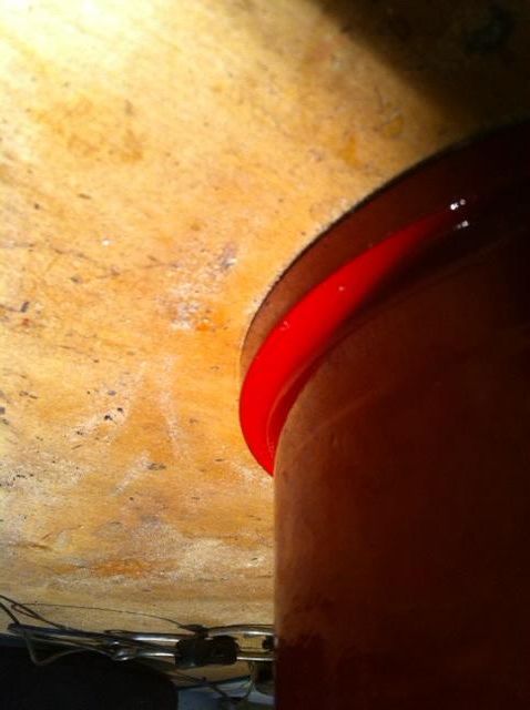

Good evening everyone,
I have been given the opportunity to be a part of a major retirement. My chief is retiring after 41 years with the City of Miami Fire Department. He has been a very influential person in my career and as one of his lieutenants, esteem him to be one of the finest chiefs the department has seen, and a fine man.
We are going above and beyond, sending him off with some unique gifts, no expense spared.
I have been tasked with the overhaul and beautification of a fire hydrant. Powder coated red, caps all chrome, bonnet bolts and nuts all chrome… I am making a rolling base for it to mount to. The flange that used to hold the fire hydrant down, is no more… So what an opportunity to make a new one out of wood!!
It will be a museum quality piece (I hope…), and will not see any outdoors. More than likely it will be moved to its home and not touched except for the occassional dusting. However, it weighs somewhere in the 100 pound range, even with the guts pulled out of it, and is very top heavy.

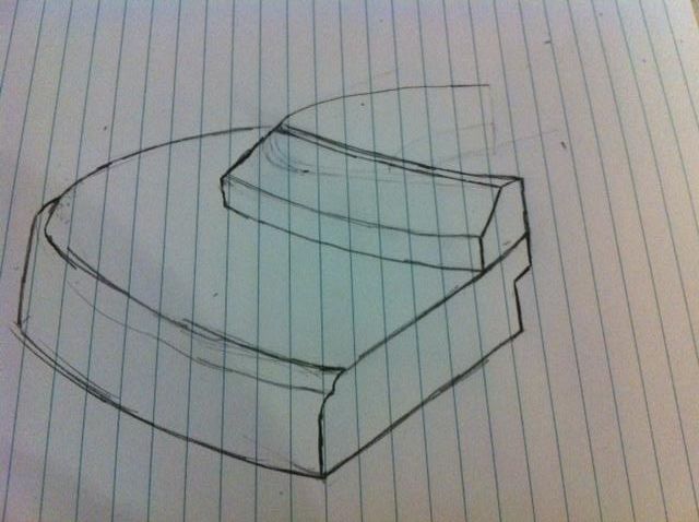

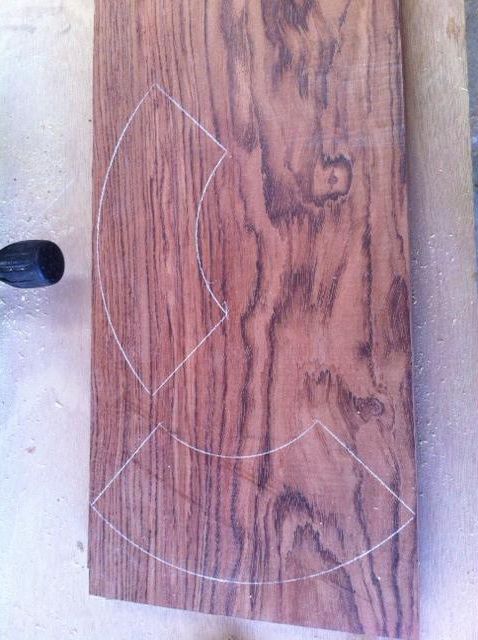

My plan is to create a quartered flange and rout a rabbet maybe a 1/64” short of the height of the lip (to anchor it down). My question is which direction should I run the grain for each of the quartered sections? Below are some pictures….. Hope they are good enough to understand what Im talking about.
Forgive my drawing. Its not the best… But it shows that I will laminate another 3/4” ring over the top of the rabbet in hopes of stregthening it. The base is going to possibly be 5/4, so the rabbet is a little thicker.

#1 posted 03-04-2014 04:16 AM
Go with the grain…bottom sketch in the bottom pic. Less end grain to deal with when you finish it. The longer grain will look better. Congratulations to the chief

#2 posted 03-04-2014 04:26 AM
Great point!! I didnt think of that very important issue!! Do you think that the lip of the hydrant will want (if the hydrant were to want to lean) to pry up on the rabbet, and being that it would be side grain, would it be easier to snap? compared to if the grain were running into the hydrant??

#3 posted 03-04-2014 07:15 AM
Agreed, go with the grain. Not only will it look better but it will be much stronger. And if you have wood with curved grain (in an arc), this is the idea situation to use it.

#4 posted 03-04-2014 07:50 AM
Sklaus, I agree w/grandpa. The other benefit is that you will have less expansion and contraction of the wood throughout the year since the wood movement goes left to right when the grain is vertical as in your pic. I would try to avoid the plainsawn wood on the left of the board as this will have the most movement and will tend to show joint gaps or warpage of the base over time. Good luck, this sounds like a great guy who will receive this beautiful gift.

#5 posted 03-04-2014 12:19 PM
Thanks so much for all your help! That’s exactly what I’ll do… And he is a great man. He’s one of those few true leaders out there that people aspire to be. After 40+ years of service you can understand why he would leave, but nevertheless he’s a great loss to our department.

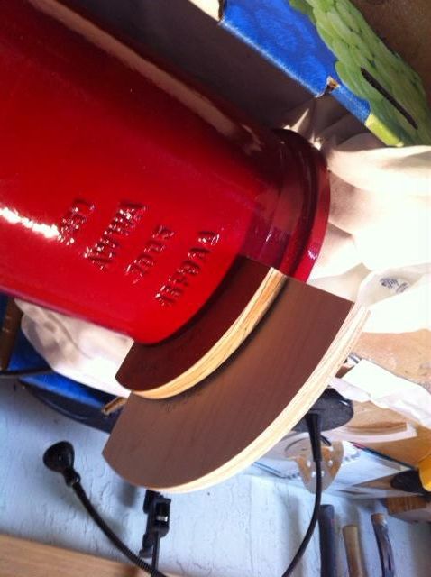

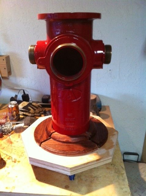

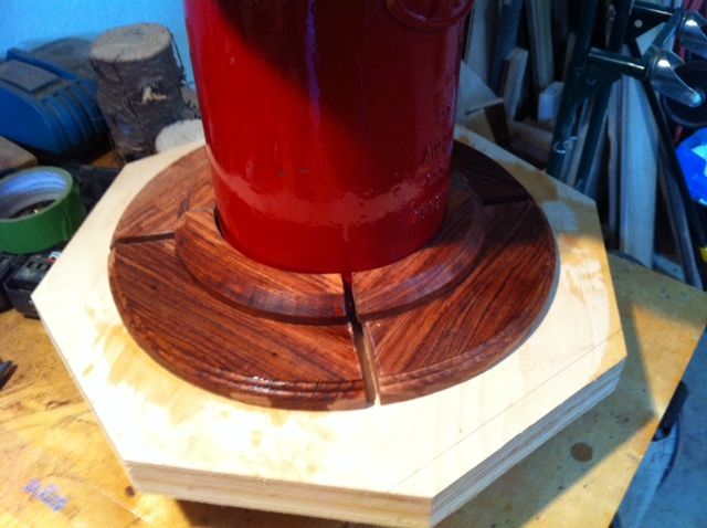

Here are the results of what you guys recommended.. I think it looks great!! thanks again for all the help to all of you….
And by the way, speaking of what it will be mounted on… Thats it right there… a rolling base with small casters that will be hidden by a skirt of bubinga. Havent decided to whether to stain the maple plywood base, or leave it natural to contrast the base and the hydrant. I’ll be happy to show pictures when its all done and finished…
