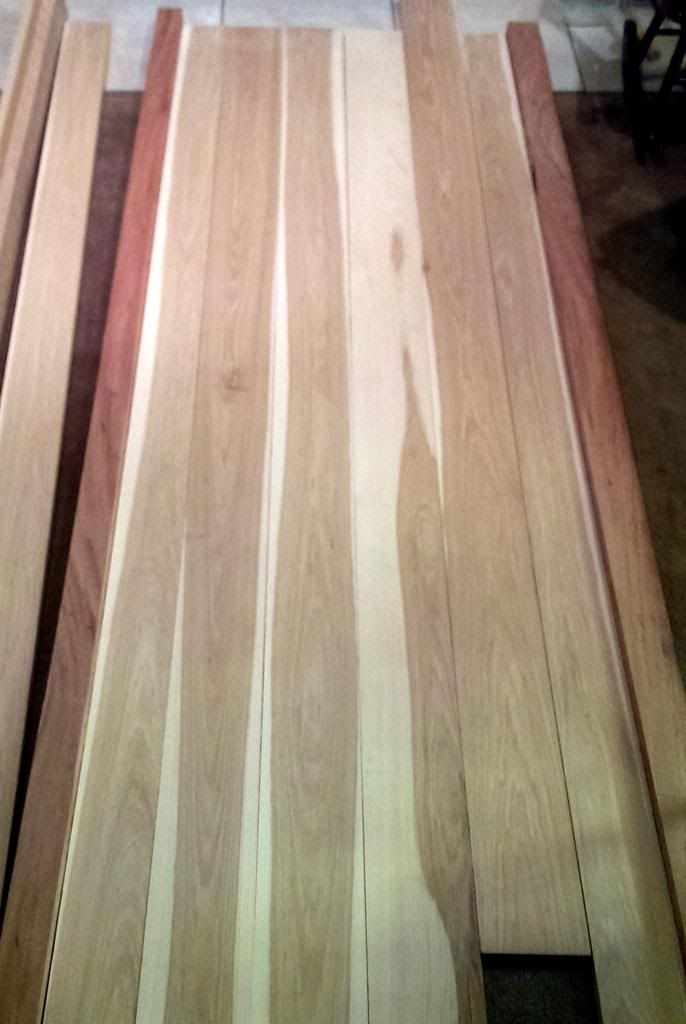

Tabletop details: Roughly 40” x 90”, hickory that is ~13/16” for field and thicker 8/4 mahogany around the edges to try and give bulk to match “rustic” base… Here it is laid out a ways back before clean up/glue up – you’ll just have to imagine what it would look like with a breadboard of mahogany (or I suppose two pieces of hickory could be face laminated together and used as well):

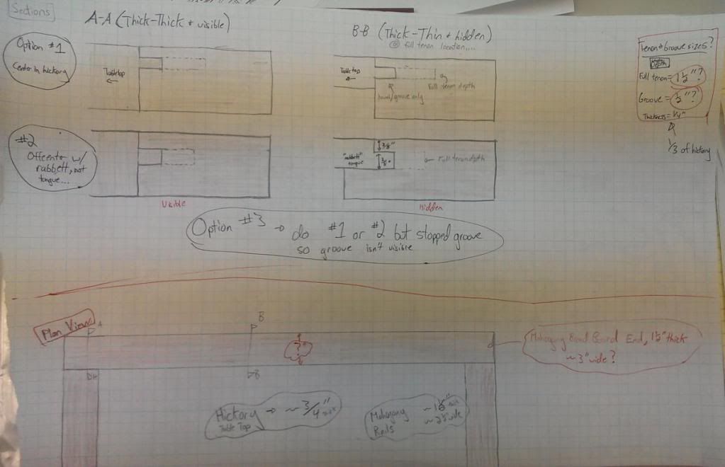

OK – since I’m going ahead with the breadboards now I’ve got a “follow-up” problem… The thicker mahogany will be what is visible, but since it has thickness differences I can’t just put the groove right dead center on the mahogany since it’ll “miss” the thinner hickory’s tongue.
I’ve come up with what I think is a clever solution that makes it work well but I’m not sure. Looking for feedback on Option 1, 2, or 3 from this sketch.
Option 1: Basically #1 is to do the groove at a normal depth on the thinner hickory (1/3 of the hickory, so it is at 1/4”, then 1/4” grooves and tenons, then 1/4” more table). This places the groove “off-center” on the mahogany, but centers it for the thinner hickory.
Option 2: Instead of a full tongue, I cut a rabbett to 3/8” of the hickory, and that goes in the groove, plus longer tenon sections. I can even make the mahogany have a supportive lip underneath the rabbet in this case.
I am doing everything by hand so one issue is that my combination plane only has 3/8” or 1/4” cutter for the groove, so those are the dimensions I have to work with there (plus it matches my chisels for the mortise).
My big worry with #1 is the fairly thin tongue/tenons getting snapped off. #2 is goofier, and I’ve never seen anything like it, but gives some more meat to the construction.
Whats everybodies two cents?
View Clint Searl's profile
Clint Searl
1533 posts in 2356 days
#6 posted 11-06-2013 07:59 PM
If the wood is properly dry, breadboard ends serve no functional purpose in keeping things flat. Seasonal movement will always show a difference in table width vs. breadboard length. No aesthetic value. Not worth it, IMO.

View pintodeluxe's profile
pintodeluxe
5654 posts in 2808 days
#7 posted 11-06-2013 08:15 PM
Do it once to prove to yourself that you can.
Breadboard ends do seem to create as many problems as they solve.
Although I think they do add aesthetic value to some projects.
I used a centered tenon, 1/2” thick. At several points long the width of the table, the tenon extends into deeper mortises for strength.

View CrazeeTxn's profile
CrazeeTxn
151 posts in 1945 days
#9 posted 11-07-2013 01:14 AM
Carl -
My second project after I built a shelf for my wife was a table. That was 11-12 yrs ago. Didn’t know anything about wood, so it’s poplar, stained, and finished.
I had a jobsite table saw, jig saw, router and router table.
After I glued the boards up, I just used a tounge and grove bit to route the ends making the tenon. You could also use a straight bit and guide on each end. Then I cut about an inch off each tenon for expansion. For the breadboard, I just cut a stopped mortise using the router table and straight bit. This way the ends could expand and contract without being seen. To fasten it, I found these things called stepped dowels, but any dowel will probably work. Snugged the breadboard up, drilled the holes, and glued the dowels all the way through. Cut them flush, sanded, and away I went. That’s the only bit of glue I used on the breadboards…it was all from the box stores 3/4” stock.
Sounds like you’ve got a plan to get your tenons. I like option 1 via option 3 as it hides the tenons when they expand and contract.

View CarlTuesday's profile
CarlTuesday
14 posts in 1658 days
#11 posted 11-13-2013 05:50 AM
Thanks for all the ideas guys – I decided to just go for it.
I went with hidden tenon/groove and option #2 (so I only had to cut one shoulder) on the top side… It took me about 5 hours to get one of them ALMOST done, and it still needs some cleanup of mortises to make it fit.
I cut the shoulder with a circular saw set to depth and then did a combination of “popping” with chisel where the wood was straight grained, cross grain paring, and sawing near the ends where I could get a saw in there. Once that was done it was mortise chopping time – my 1/2” chisel got a nice workout and so did my arms. I did have one careless slip and mash my finger into vise though…
Finally, I plowed a groove between the interior mortises with my stanley #46 (first time to use it on a real project).
It was getting late and needed to shut it down for the night, but I got it all the way to here, so I’m happy with the progress:
I’ll have to clean up the tenons a bit more to let the joint close, but I’m pleased to get this far without major incident. You might note that in the photo I’ve left the breadboard end both a little thick and a little longer than the top – given that it will always not quite match I may leave it that way, or maybe take some thickness off… Haven’t decided yet.
Thanks again for all the tips.
