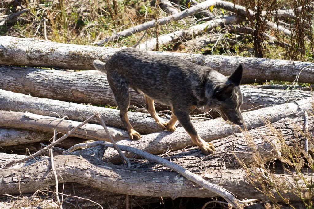

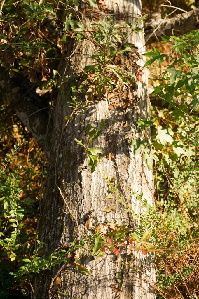

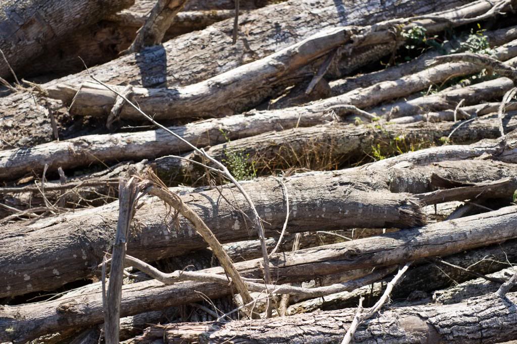

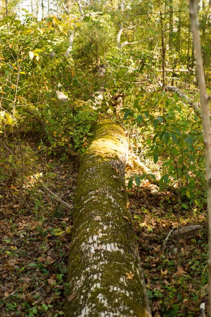

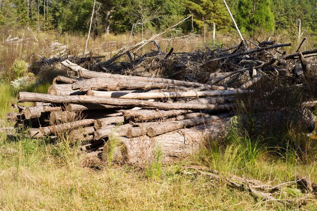

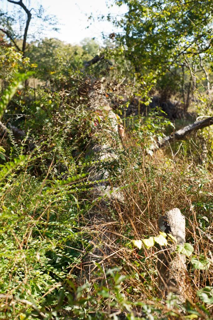

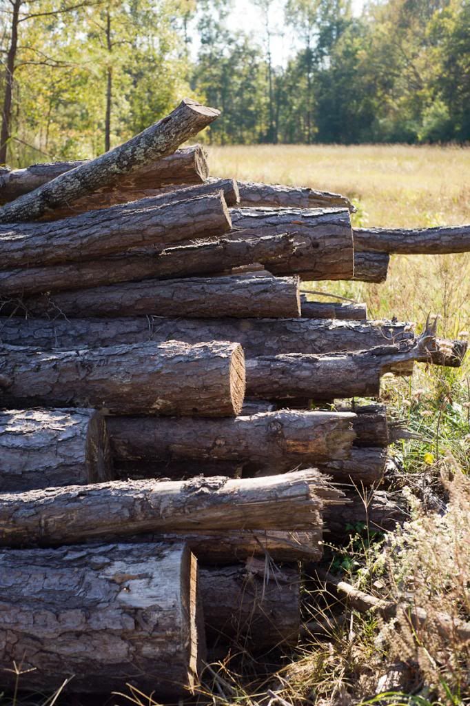

Last fall a large portion of my family property in Milledgeville Georgia was logged, mainly the back 40.

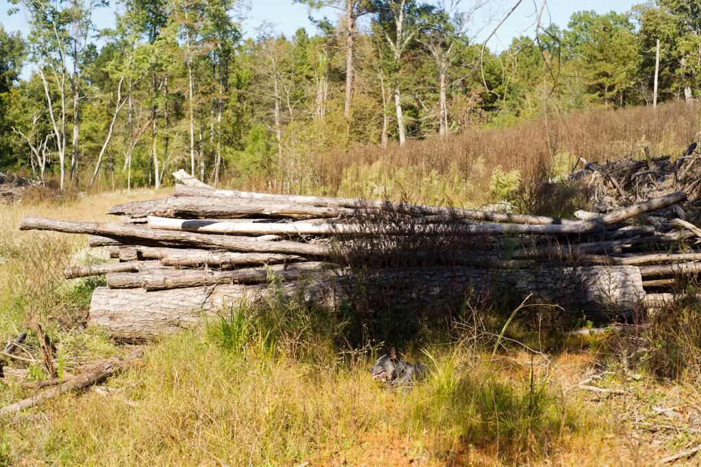

The loggers left about half a truck load of timbers in the field by the processing and loading areas.
Went out and took some pictures today. Not sure which logs that have been on the ground are salvageable for lumber, or just have seasoned into firewood. Pine pile with the hardwoods mostly white and red oak, ash, poplar, and maybe a hickory dogwood or elm log too.

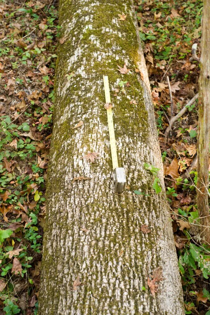

Light on cash at the moment, so I am searching for a sawyer in the middle Georgia area that would like to barter milling in exchange for a percentage of the lumber. One other person and myself would be helping with the milling. Also have two storm blown oaks that I would like to mill along with four pines and a few hardwoods still standing.
The property does not have a tractor to move the timbers to a central area, but I can fell, limb, and section the logs to be moved with a truck and chain. What else is necessary to help along the future milling?

Any idea if the year old pine and hardwood piles are good for lumber?
Is the timber an acceptable amount for a sawyer to be interested?
And what would be a fair and typical percentage?
View Don W's profile
Don W
18068 posts in 2079 days
#3 posted 10-20-2013 10:57 PM
you should be able to get lumber out of year old pine. I’ve cut some much older than that.
Some of the logs are to small for logs, but some look pretty good. I too wish you were close.

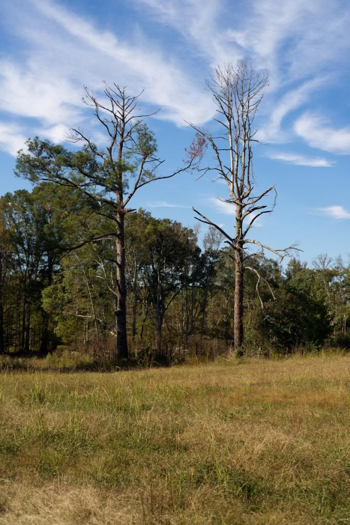

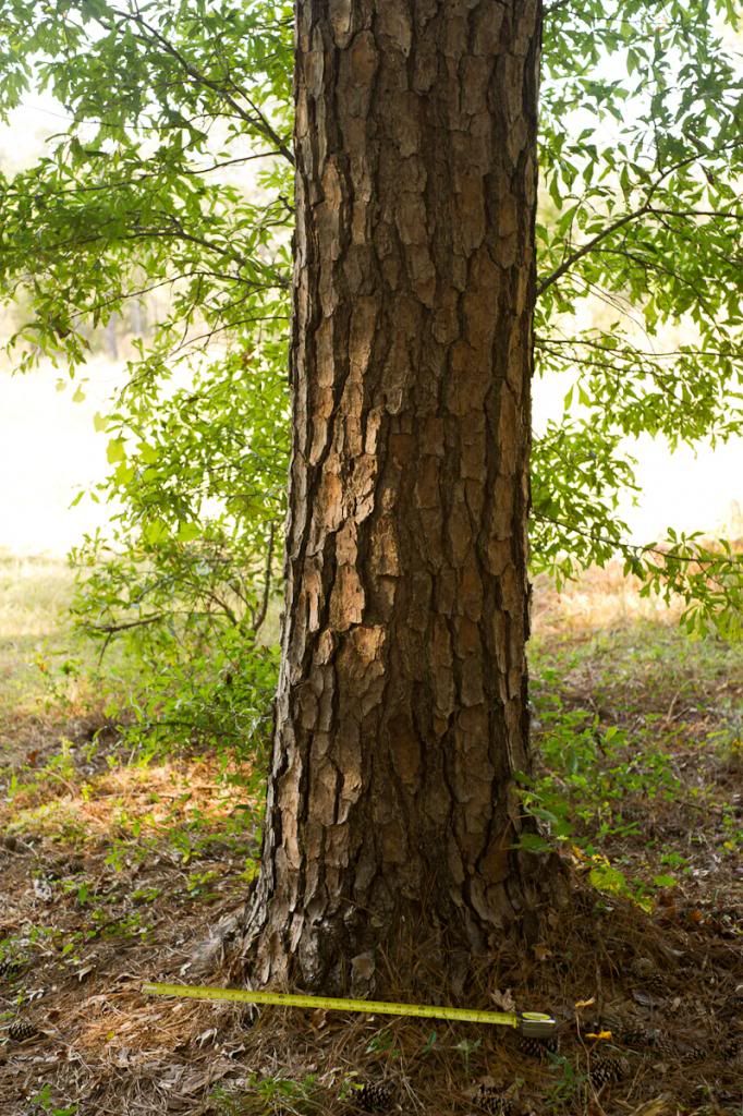

And good to know about harvesting from old pine, any thoughts on the standing dead pines?

Tons of variables, but 33-50% of the load would be typical here in NW Oregon. Bugs are your enemys, I am unaware of your location but termites would be having a nice snack on it all by now if they were here. Best to get it done soon if at all. The sections that are in contact with the ground are the biggest worry, those resting above should be perfectly fine.
