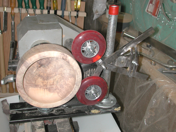

You may want to buy or build yourself a couple of steady rests. they help take the “flutter” out of the wood allowing the tool to continue its path.
From wood lathe and tools
As others have already pointed out there are several factors and and no single answer.
