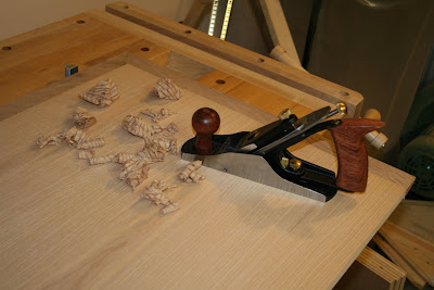

Here’s one reason: After I used biscuits to align the edging on this desk top, it was pround. The bench plane saved me because there was no other way to trim something that wide unless I had a very long flush trim router bit…which I don’t. Also, flattening a panel after glueup. End grain squarring. Lots of fine detail things. -- You can discover more about a person in an hour of play than in a year of conversation. (Plato) |
