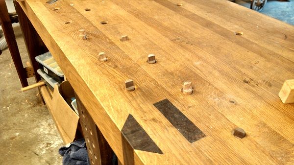

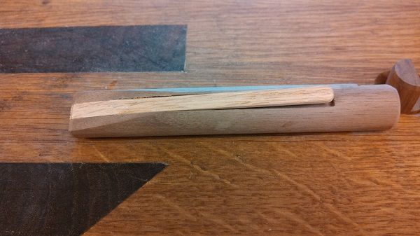

Not only can metal dogs be harmful for your tools, they dent the wood. All preference of course. A fellow LJ made these dogs for me. I love em. Don’t under estimate the convenience of a spring-loaded dog that stays in the hole. Just push it up or down when you need. No moving them around.
Pretty easy and cheap to make:
