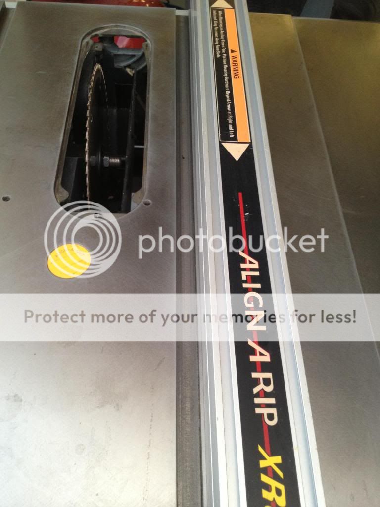

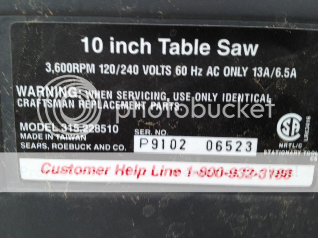

Here’s the plate on the saw showing the model number:

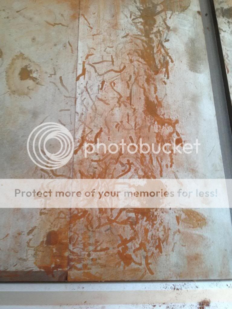

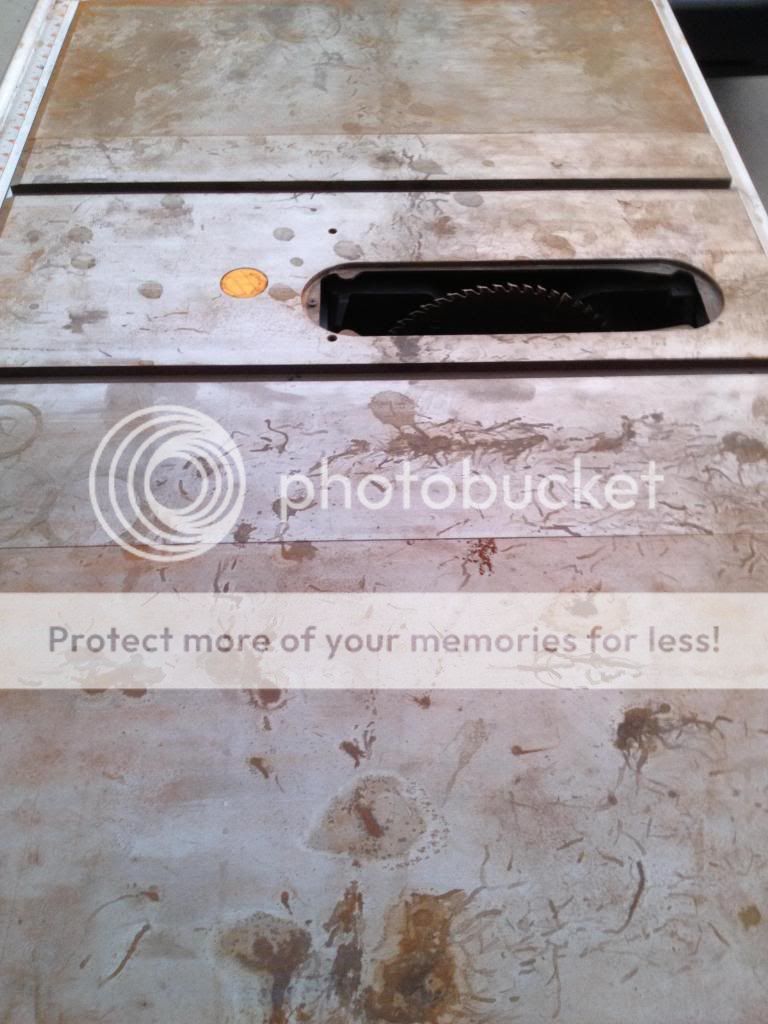

I had a little time so I started to clean the top. It started looking like this:

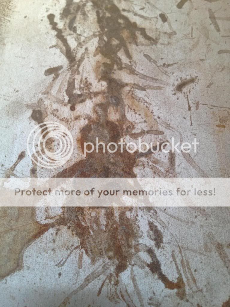

The picture really doesn’t do justice to how nasty the top was. Rat poop piled on it with pee and rust for good measure. A close up:

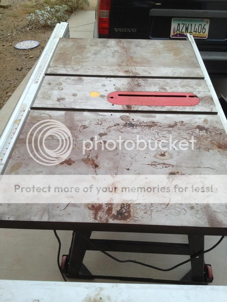

I went over the top with a scraper. The first time:
The second time. I also went through the miter slots with a wire brush:

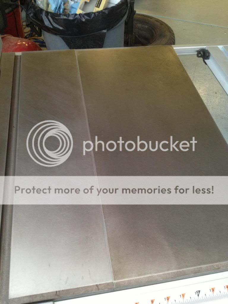

Here are the ‘after’ pics now I’m done with cleaning and polishing the top and reassembling the table. Left to do is to make some zero clearance inserts, replace the belt and align the blade to the miter slots.

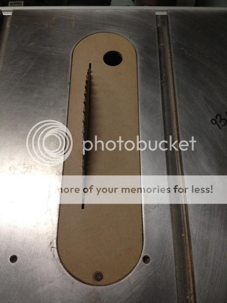

My zero clearance insert made from 1/4” MDF. I hate working with MDF, but Home Depot was out of small sheets of 1/4” birch plywood and I am just too impatient to wait.
Good first crack and making another (or several) from plywood will be much easier now I have a good template.
Got some kick back from the blade when I cut the strip on the table saw. I’m pretty sure the rip fence is parallel to the miter slots so it must be the blade out of alignment. That’s the next job. I have to work out some contrivance to index my dial indicator off the miter slots.
