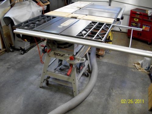

With a thin kerf blade your saw should have plenty of power. The .113 is a very proven saw that many people use for the finest of cabinetry. Unfortunately, the saw doesn’t come with a riving knife AND has blade wobble which can be dangerous. I’m not sure how involved replacing the arbor is but if its not to bad I would go for it. Get the saw aligned and give it a good fence and a sharp thin kerf blade and it will do whatever you want it to.
the only plus side to buying a new saw like the ridgid (also very proven) is you get the riving knife. I think that a riving knife provides alot of safety. The fence is much better then the craftsman but IMO does not compare to a t-glide fence.
