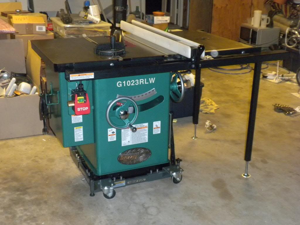

I have decided that it is time for an upgrade. The saw that my dad left me (1960 Craftsman contractors saw) has had its day and deserves a proper burial.
I want a saw that will last for the rest of my work working days (I am 57) and pass it along to my son.
From my research I have narrowed it down to Grizzly as a brand based on what I have read about the quality of the saws and the customer service.
My budget is $1500.
I am seriously looking at the following two saws:
  • G1023RLW 10” 3 HP 220V Cabinet Left-Tilting Table Saw ($1500 with shipping)
  • G0690 10” 3HP 220V Cabinet Table Saw with Riving Knife ($1445 with shipping)
Grizzly has a nice compare feature on their site and I can see that there is little difference in the basic saw, I have no experience with either fence that is offered, the miter gauges are different and one has a router insert built in (nice but not a big deal for me but for $100 I will go for it).
I am hoping that some of the sage folks on the site can shed some light on the subtle differences in these saws and is there a saw that someone believes is worth another look that is within my range.
Thanks in advance.

That’s a pretty common question. Both are solid choices well proven choices with excellent track records and large happy followings. It’s a coin toss from what I’ve been reading.
The G0690 has a larger stock rip capacity, an Asian made Leeson motor, traditional triple belt drive and swing arm, and is made in China.
The G1023RL has an updated wide serpentine belt, dovetail ways and mechanical elevation screw for the vertical height adjustment, the Shop Fox Classic fence, a blade shroud, and is made in Taiwan. You can “add ~10 rip capacity if you want it.

Thanks for the help, I ordered the G1023RLW, should have it by the weekend.
-- By hammer in hand, all things do stand.

Excellent choice! I have the same saw and have absolutely no complaints. I love the router table, I use it all the time. If I had to make the same choice again, 690 or 1023, it would be the 1023. I really think the modern design is an upgrade, though the 690 is a fantastic saw.

The saw showed up with some minor shipping damage (hook for wrenches bent beyond fixing and the motor door is bowed and scratched but I think I can get it back in shape and the scratch is only about 1 1/2” long, so I will jusy touch it up). Thanks goodness my son is around to help get the beast into the dolly. Have to get a different plug for the 220V outlet that I have, hope to be making dust tomorrow.
