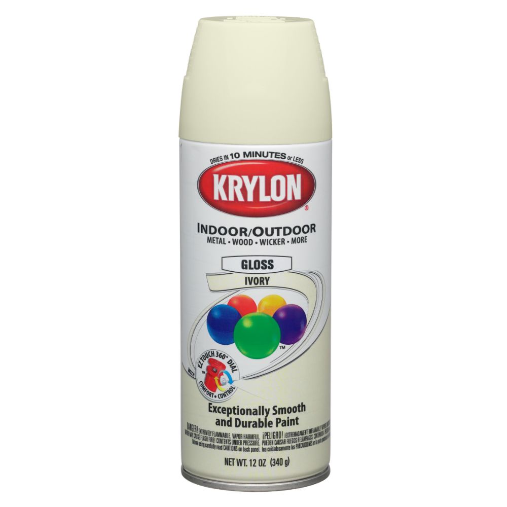

1956-7 Powermatic 60 8” jointer
Original gray :
After Krylon Primer and Ivory (Gloss) rattle cans :
-- When did quiet and quite become the same word ? I'm guessing about the same time as your and you're did.

#11 posted 109 days ago
Dusty, I sure would not have thought you used rattle cans. Looks like you used a spray gun.

View Dusty56's profile
Dusty56
10531 posts in 1859 days
#13 posted 109 days ago
PG51 , thank you very much : ) I’ll have to give credit to the excellent paint and their awesome spray nozzle.
$3.67 at WalMart in my neck of the woods .
