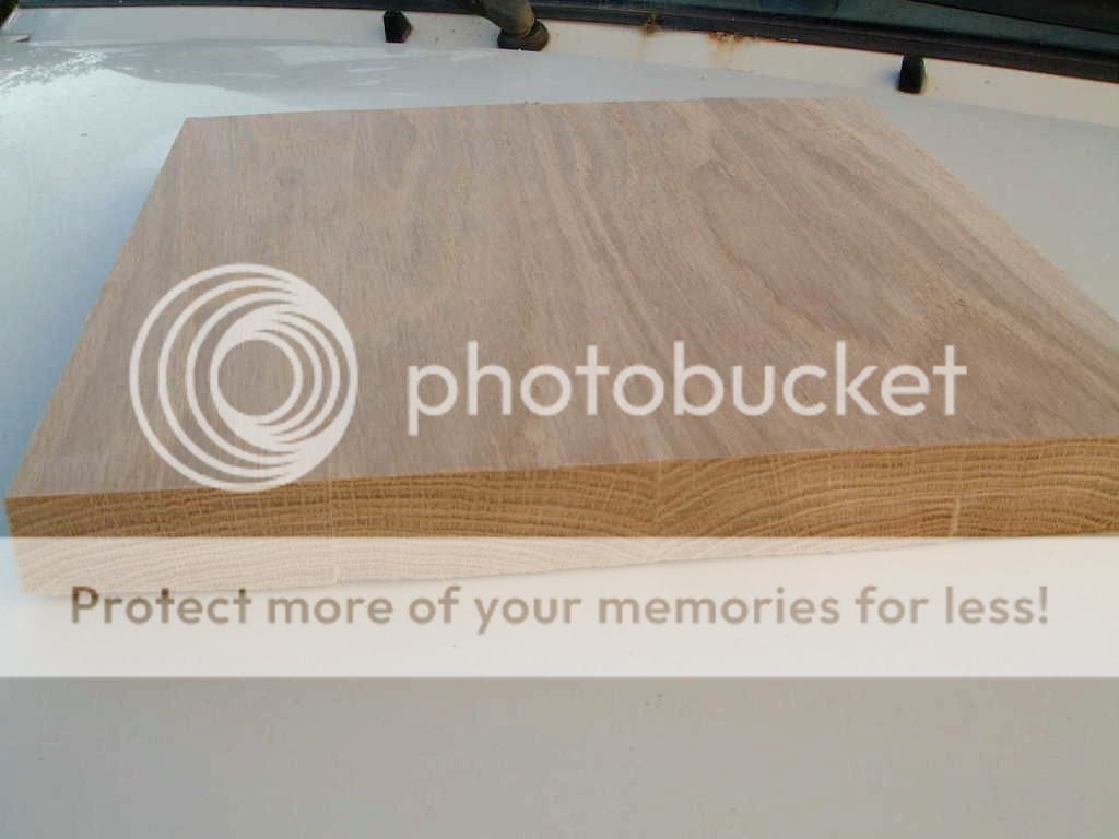

I’ve just bought some oak from the local, err well, the only lumberyard nearby (I’m in Portugal). Portugal is, as you probably know, a land full of magnificent oak trees (some cork oak, others not), which it’s illegal to fell, so this is, I was told, from America.
It IS oak, of this I’m sure, but is it red or white?
How can I tell?
I’ve looked at pictures on the ‘net, and the “white oak” pictures look redder than the “red oak” pictures.
I was hoping to make some outdoor furniture with it – Timelife recommends white oak for this, but says red oak is unsuitable (but doesn’t say why). Are they right? Will I spontaneously combust if I sit outdoors on a red oak chair? Will it dissolve in the first rains?
Any thoughts appreciated before I start, or don’t start, work.
As an aside – what thoughts on my alternatives – choices are limited to beech, ash, pine, and african woods I don’t want to use.
Aside aside – I was also offered “tola”, but I can’t find out much about this.

Red oak is not rot resistant while white oak is. That’s the reason you don’t want to use red oak for outdoor applications.
One way some boat builders use to identify which oak you have is to try to blow a mouthful of smoke through a piece 6 or 8 inches long. If you can blow the smoke through it, it’s red oak.

A lot on Charlie’s site seems to involve comparisons. For example – “Look for the rays (long horizontal marks), which will be longer in white oak”, which won’t work since I have only one sample. Much seems also to be about growth rate.
My oak
1000 words
seems to look more like the white than the red – but that’s in someone’s part of the country.

That is white oak. A closer shot of the face grain and end grain would confirm it 100%. The growth rings are too close together for commercially available red oak.

White oak has occlusions in the vessel elements called tyloses. These basically plug the pores enabling white oak to be used in barrel making. Red oak does not have tyloses and cannot be used for barrel making. If you look closely at a fresh, clean cut on end grain, red oak will have open pores while white oak will have pores that are plugged. The “blowing smoke” trick is also a function of the pore structure. Hmmm, haven’t used some of those words for over 25 years. Back to lurking.

I agree with Daren. It looks like white oak to me. Another variation of blowing through a piece is to stick one end in water. You can blow bubbles with red oak, but not white oak.

This is definetely white oak. I am 99.9 per cent sure of this.

Yup… white oak… end grain is plugged.

Red oak does not like moisture hence is not used for exterior projects. Water will turn it black. White oak is more resistant to water & in Eastern Canada is often used for decking to take advantage of the wear characteristics.
