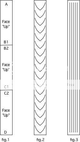

So, I’ve signed up to photobucket, and here’s the pic (I hope)...
1000 words
Fig 1 – the bit of wood that I’m going to chop into 3 and glue into a single panel.
So, I guess the questions are…
1) If there were NO grain pattern at all (virtual wood), what would be the ideal format for gluing the 3 bits into a single panel?
2) The grain actually is like fig 2 (face up) and fig 3 (face down), so it won’t look right to have face up, and face down pieces on the same side of, say, the table top, so what’s the ideal configuration there? Personal taste excluded, keeping all pieces face up, which is best/strongest of…
a) A to B2, B1 to C1, C1 to D (slide)
b) A to C1, B1 to B2, B1 to C2 (rotate)

think about it this way – if the wood is going to cup – it will cup! there’s no way around that in this situation. the question that you need to answer for yourself is this: would you prefer the wood pieces to cup and form 3 “facing up” C’s but have the grain look RIGHT, or would you rather it cup and form an “S” and have the grain all mismatched…?
I’d go with option 1. and especially if you have shorter pieces – cupping will be so minimal (if any at all) that it would be practically invisible in most cases.
