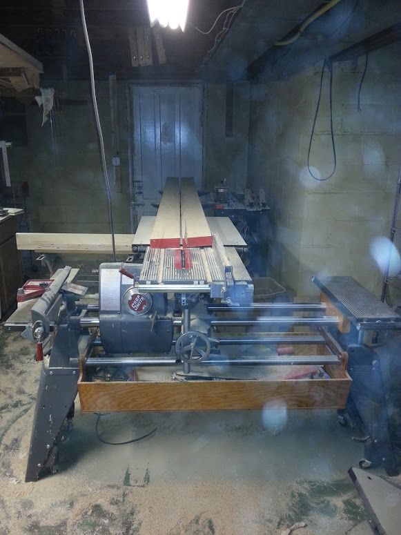

Well, I’ve got a few projects under my belt now, and since I now have a mountain of 8/4 ash, it seemed like a good time to build a split top roubo. The question was, can a shopsmith handle 9/4 solid ash lumber that’s 12 inches wide and 11 feet long? It turns out it can.

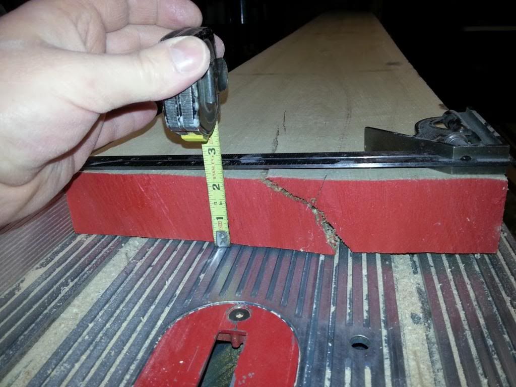

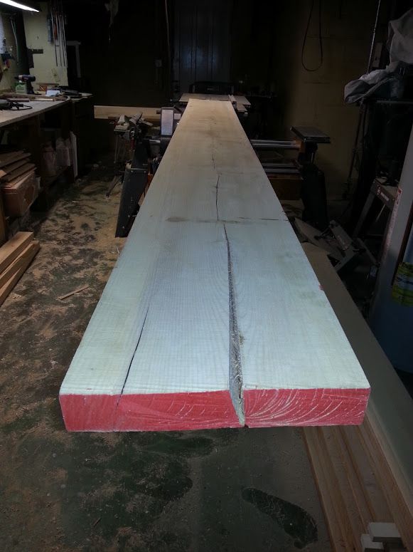

The pics below are the setup for the first of 10 ash boards 2”x12”x11 feet. These boards are the rejects from 2100 bdft I cut this fall on my family’s land in Maine. I had the sawyer cut all nominal thinkness by 1/8” oversize, and some of it would up being 1/4” oversize (all of my “8/4” is actually between 2.125” and 2.25”). I picked these particular boards for the bench because they were either knotty, or had severe checking that made them good candidates for the narrow boards on a workbench.
You’ll note that the board is nearly as wide as the shopsmith’s table, which may be an indication that it was not meant to cut boards in this size!
Now I have a couple of handy ash 2×6’s. I’ve got to get that dust collection working again however…

@Ron in Ohio: I actually pulled the woodworker II blade off. On the first board that I tried to rip with the WWII blade I tripped the breaker. It occured to me the the WWII blade was probably the most valuable piece of the whole kit, and that I didn’t want it involved!
I pulled it off and put in a shopsmith branded 24 tooth ripping blade that came with the set. What a difference. I had never used a ripping blade before and I was really impressed. It pulls out long curls rather than sawdust. I’ll never rip with a combo blade again. Once I put the ripping blade on, it was like a hot knife through butter. Granted, my feed rate was relatively slow and careful, but I think it would be even for the best contractor saw on thick, heavy, dense lumber like this. I ripped enough 2.125” x 12” ash to build a 400lb roubo in about an hour. I don’t think my father-in-law’s contractor saw could have done it.

With a good 20-24T RIP blade, almost anything will rip that board.
In this case, I’d be far more worried about a board that hasn’t been jointed being ripped without a splitter kicking back, than if the saw would cut it.
A good blade, designed for the purpose, makes all the difference. My Shopsmith and I have ripped 4” (3.5”) X 8” hard wood. Not 11’ long, though!! As far as width is concerned, the auxiliary table serves you well. BTW, the WWII is a decent blade but, on a whim, when mine dulled, I picked up a Tenryu. Now the re- sharpened WWII sits gathering dust.
@Dan: Good to know I’m in good company using a Shopsmith. They’re good little rigs!
@Bluekingfisher: I was originally intending to rip them with a circular saw. I was really just curious to see whether the Shopsmith was up to it. It worked so well that I decided to do the other 9 boards on the Shopsmith. It’s easier on the knees :)
@Cessna Pilot: Your are dead right about the splitter. The Shopsmith actually has a built in riving knife as well as a cam-based anti-kickback device. I took it off to change the blade from the WWII to the ripping blade. It really wasn’t safe to do that board without it. It went back on shortly after. Although the title was a joke “don’t try this at home” you actually shouldn’t try that at home and I shouldn’t have either.
