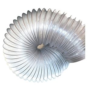

I am looking to buy enough 4’’ hose to hook up 14 blast gates for my cyclone system that I am currently installing. I am putting in all metal duct, 26ga snap lock. What kind of hose do you guys recommend the PVC or the Polyurethane? I know the Ply is best but is it really necessary for a hobby shop? Also how many mills/thickness would you recommend to use? And the most important question is where can I get the best deal on it?
Also what kind of clamps are you using to connect it to the blast gates/ machines?

I searched for a while, and here's the best deal I found online
At the time I bought it a couple months ago it was $50 for 50 ft. Looks like the price has crept up since then.
The quality is decent and the thickness seems to be good enough for my 1.5HP dust collector. It doesn’t collapse or anything.
I bought a few of these clamps to go with it
They’re definitely handy, but I don’t know if they’re worth the extra $ over the standard screwdriver type clamps.
Good luck!

I’d recommend, if you want to save some money, that
you set it up with black polyurethan hose. Chances
are only 1 or 2 machines will have clogging problems
and you can replace those with clear hose later if you
like.
The clear is a lot more spendy obviously.
The best hose for larger chips is the really stiff stuff
that is hard to bend. The insides are smoother and
the 10 ft length I have of that has never clogged.

Ditto on 1stmistake I have been using the black 4” flex hose, its heavier gauge but not as smooth inside (more ridges) so I would use the clear.
