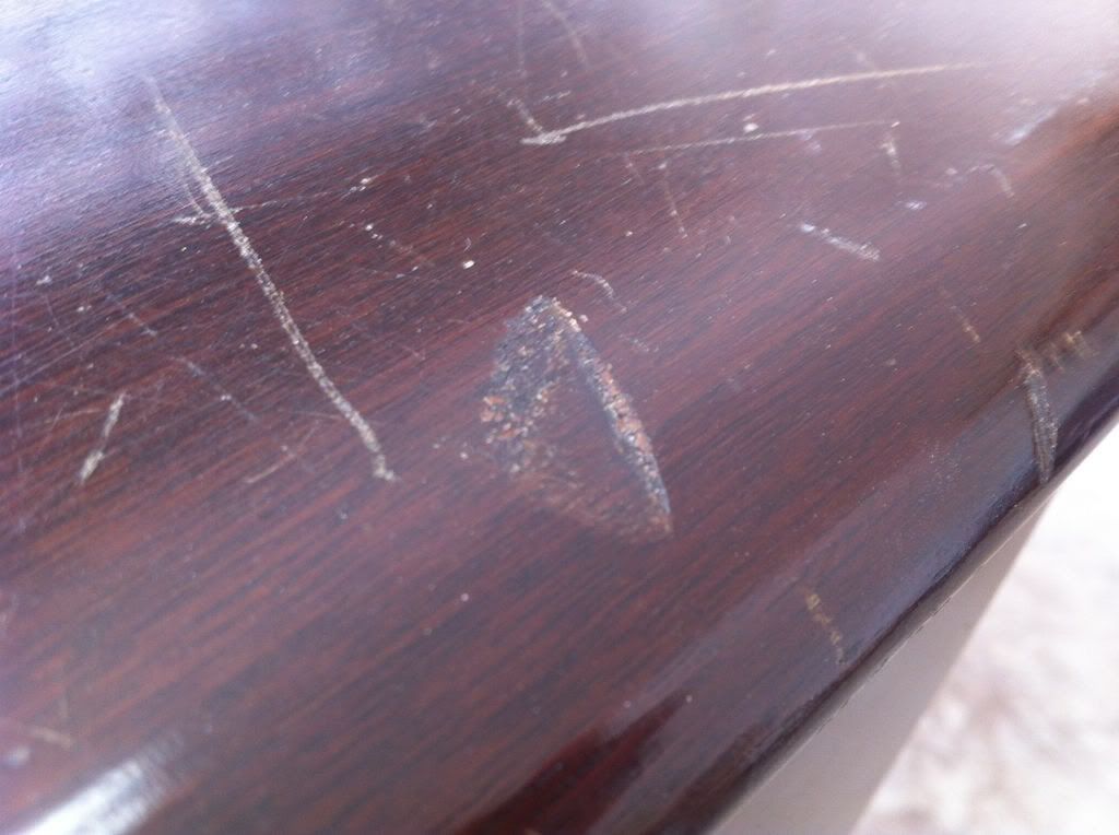

I am in the process of refinishing a pre/post WWII chest of drawers made of mahogany, it’s a manufactured piece from Kling if anyone recognizes the name… I believe out of Michigan… Like a lot of other furniture. I salvaged it from a Salvation Army and the finish was very badly damaged… Many dents, deep scratches, and chips… I decided to strip it being that I felt the finish was to far gone….

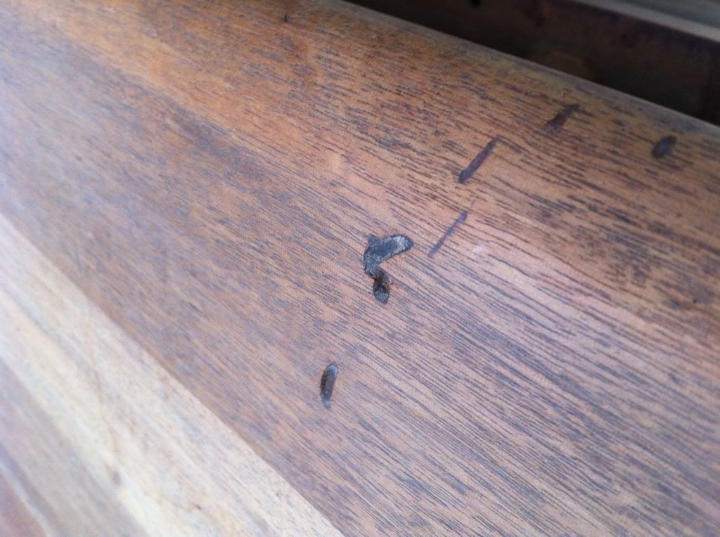

Yes, and thats what I did. I removed the finish… the lower 2 photos. I just don’t know which route to go now.. Should I …

Repair first. Your best chance of matching everything up is having the finished areas exposed to all the chemicals, stains and finishes with the old wood. I would have repaired even before I stripped it down. That’s what we always did in my refinishing shop. Lots of times, the old finishes will melt into the new areas, giving them a patina closer to the old wood. You would be surprised how much blends in when you strip something that has had repairs.
But you are past that point, so repair as soon as you can, then maybe wash it with a tinted lacquer thinner before starting the finish. And yes, you will have to use grain filler if you want a mirror finish. The Deft will sand down nicely as you lay up coats, but you will find yourself using 1200 grit, and then a good swirl polish like Novus #2 or Megula’s swirl remover will give the lacquer a high mirror gloss as a final polish. Use all cotton T-shirts, not those terry cloth towels they sell as rags, or you will scratch the final finish.
