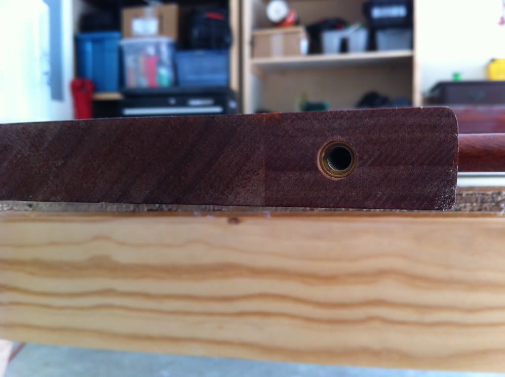

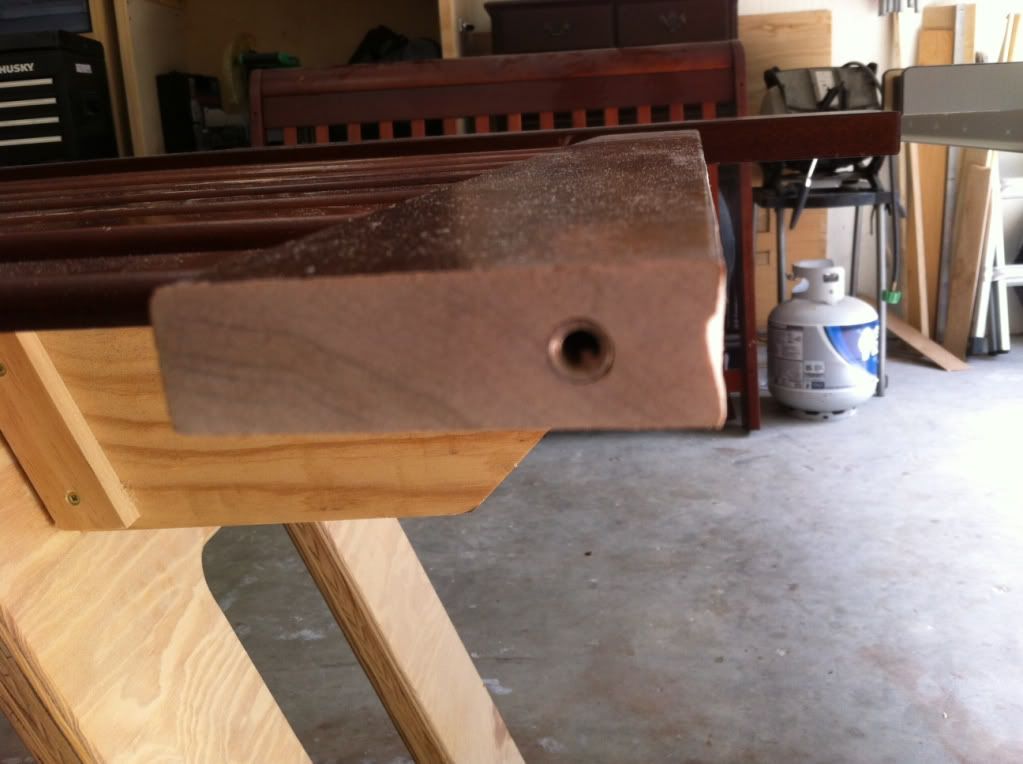

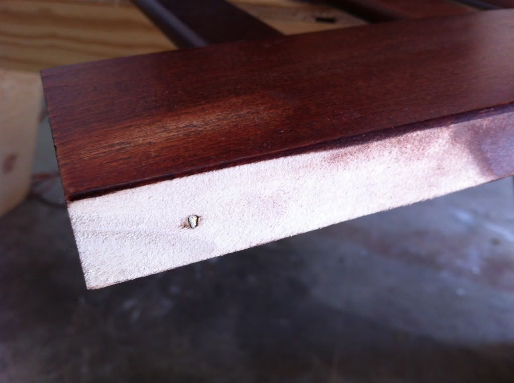

Hi all! I’m still pretty new to this site and woodworking in general, so forgive me if this question seems a little elementary…
I have a friend that has a toddler bed that he wants refinished. He brought it to me to see if it was refinishable. Upon inspection it seemed to be a mahogany type wood, the end grain looked right, and so did the side grain… Open grain, filled… Used the litmus test (or lacquer thinner test). To see what kind of finish it had… Whatever it is it does dissolve with lacquer thinner… It is noticeably a light weight wood… From our favorite country… China! (go figure…)
But as I sanded thru, it seemed to be some kind of balsam wood… It has no grain texture, but it doesn’t seem to be MDF or particle board… Wondered if you could help… Here are some pictures… Once again I apologize if my novice shows in this question… But I’m learning, and I know there are some sound, veteran woodworkers on here…

16276 posts in 4303 days
#3 posted 08-22-2012 02:12 PM
The photos are a bit confusing. The first one looks like a veneer on MDF, but the other two clearly look like solid wood.

View SKlaus's profile
SKlaus
52 posts in 2474 days
#4 posted 08-22-2012 02:23 PM
The first photo is where I sanded thru the finish…. On the bottom side of the crib…in an out of sight place… In case they wanted it back in usable shape… It does not appear to be veneer being that with simple lacquer thinner, the finish and stain came of with a couple of strokes…. I did a little more research and it seems “whitewood”. Is a broad term for poplars, pines and spruces… They apparently have different types over there than we are used to seeing here… And being it comes from china… We may not be familiar with it… I tend to agree with lee… It’s probably some very inexpensive, and light weight wood (shipping in containers across the pacific)... That’s just structually sound enough not to be sued for injury claims but is not sound enough for salvage or repair… If anyone else has more info, please feel free let me know… I’m learning, and any info I can get is a huge help…

View Tomj's profile
Tomj
204 posts in 2466 days
#5 posted 08-22-2012 04:01 PM
The second picture is definitely a conifer, soft wood and the the third picture looks like Poplar stained but I’m not positive on that one because it’s stained.
