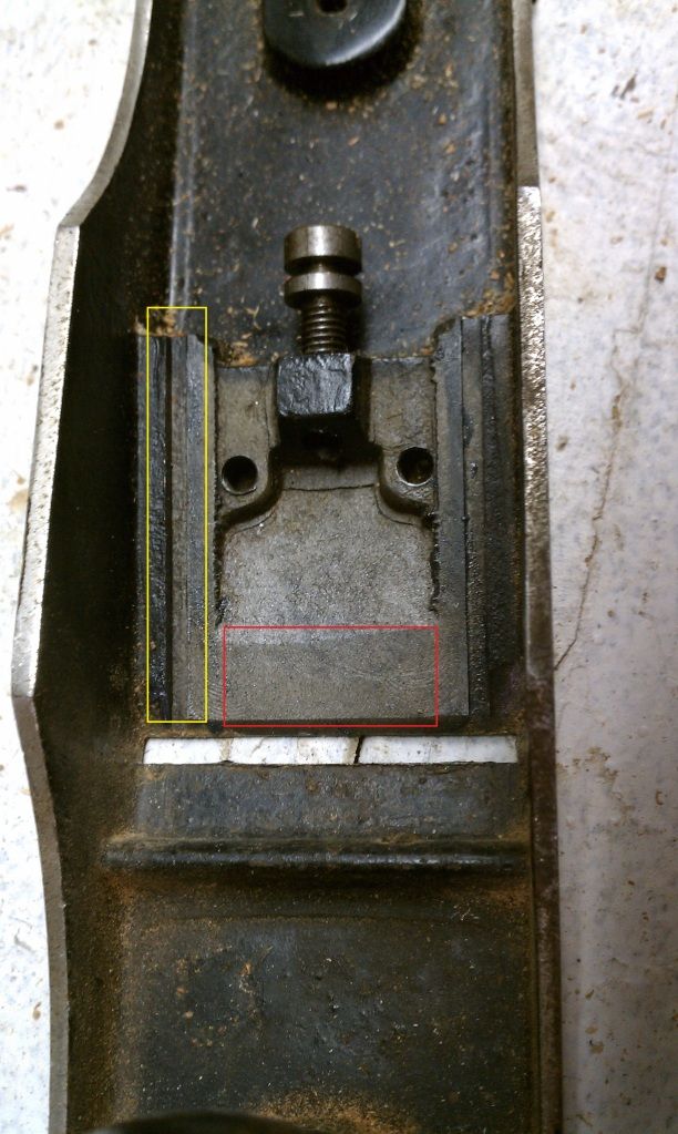

The reason I started using valve grinding compound with the frog and frog seating area is that the machining on the frog seating area didn’t seem that great (but I have nothing to compare it to). I posted a picture of the frog seating area on the Vaughan and Bushnell 905 in question. I painted the whole seating area with a black sharpie and then did a bit of abrasion by sliding the frog back and forth with valve grinding compound in the frog seating area. The area in red didn’t seem to be getting even contact with the frog. If you look at the area in yellow, there is a channel that is 1/8” wide, and 1/16” deep that sits to the left of the frog seating runner (it’s right in the middle of the yellow box). The runner is getting contact the whole way down, so the valve compound started grinding a 1/1000” groove in the underside of the frog from the grinding compound. I don’t really want to grind a groove in frog, which the reason I stopped doing it and then posted the question. I think that ShaneA’s solution of using self-adhesive PSA sandpaper would solve the problem.

I would kind of doubt that it’s the frog seating that is causing your chatter. But if your real concerned about it, sand or file away some of those paint globs that seem to be there, especially on the right side of that photo. In fact, a flat file to that whole area might easily clean things up for you withour screwing around with valve grinding muck. :D
