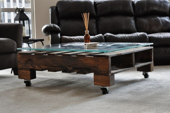

Here’s something I found on Etsy.
Link to this $400 pallet table
