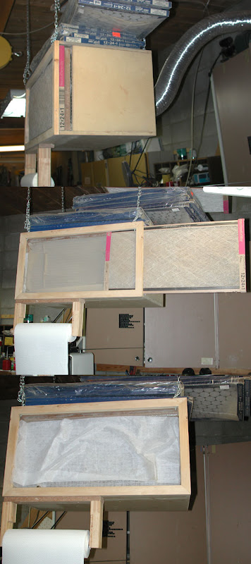

You could make your own for a lot less.
It’s just a nest of filters with a fan system pulling air through it.
I made one for about $25.00 five years ago and it’s still going strong.
There’s a furnace filter to catch the big stuff and some remay cloth to catch the fines. I just toss them out as they get plugged up.
I have obtained 3 -5” CPU fans from and old computer system and will be installing them shortly to get rid of the bigger blower.
A 24 hour timer turns it on for 2 hours every day to sweep the air in the space.

Bob – Looks like an interesting design. The JDS has an electrostatic pre-filter + a bag type filter rated to remove 91% of particles in the 1 micron range, which are the ones said to pose the greatest health risk. I’ve seen people simply tape a furnace filter to a box fan. Such a setup is probably better than nothing, and will likely catch a lot of the larger “nuisance dust”, but unless you build one with the same level of filter elements found in the better commercial units (the filters alone cost about 50 bucks each) I think it’s unlikely you’re eliminating the more dangerous bits.

3053 posts in 919 days
480 days ago
I have to agree with you in principal Dan.
The reality is that the electrostatic filter can do just what they say .
I have one on my forced air furnace in my home.
By the same token, the ultra fine remay ( spun polyester) cloth I use has a filtration very similar to that of the elctrostatic device and saves me the time the trouble of having to take it out and spray it down with water , let it day and reinstall it.
I simply cut another sheet of polyester cloth and dispose of the old one.
It takes about 30 seconds. the furnace filter just asctas a baffle to slow the particles down so they adhere to the cloth.
The cloth I am using comes from a dress making store and costs me about 50 cents a yard.
If you look close you can see a piece of it clinging to the front in the thrd picture box down.
Cheers

I wanted to update this conversation with an actual photo of the non woven cloth used for trapping dust particles in my shop.
The material on the left was in use for about a month. The material on the right is new .
a href=”http://picasaweb.google.com/boboswin/MyWoodfolder/photo#5231052682092779890”>
I’m very pleased with the efficiency of this inexpensive solution and how easy it is to maintain.
