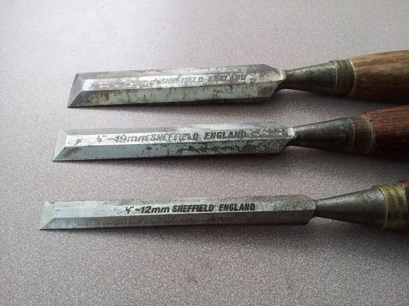

Hey everyone,
This is my first post on LumberJocks, and I am very happy to begin posting on these boards. I have for the longest time used this forum as a great learning resource, as there is a vast amount of great information here.
What I’m looking for is some opinions on whether these chisels I have are worth the time and effort needed to restore them. My dad had these laying around in the garage, and I figured I would restore them back to working order if they were worth it. They are in pretty rough shape, but I enjoy bringing new life to older tools. I haven’t really been able to find any info on these. All I know is that they are Craftsman, and I’m guessing were produced maybe in the 80’s-90’s.

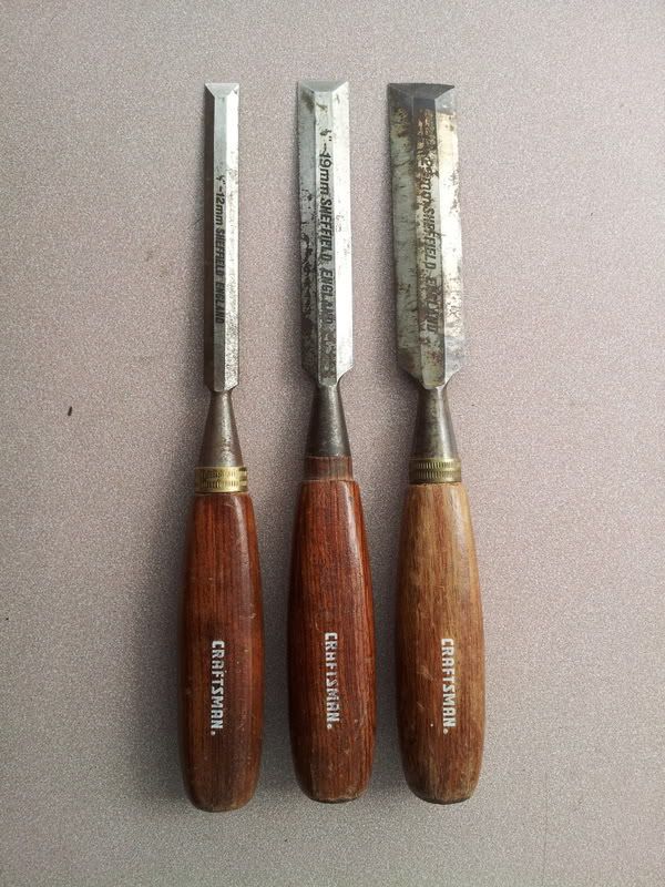

These are the 3 chisels I have:
My first question, is the steel a good steel? There is Sheffield England stamped onto the chisel, and from what I understand, that is a good quality steel, but I’d like to get some other opinions. Should these hold an edge well?
Secondly, these are most likely a lower end chisel set, with no collectable value correct? The reason I ask, is because if the steel is good and worth restoring, I was thinking of making some new handles for them. The tops are beginning to crack, and I would like to add my own personal touch to them.
I think for now, those are my 2 major concerns. I would greatly appreciate any info, or insight you can give me. Thanks!

They certainly appear to be worth bringing back as users. The bevel ‘sides’ are consistent between each of the three, and go from zero at the edge to not much close to the ferrules. Note that they’re likely metric / not true imperial measure (one is true, other is approximate) if that’s impotant to you. Sorry, but no insight on steel quality or composition.
Good luck w/ your decision.

I am sure they are not worth any monetary value, so the question is what value are they to you?
I think making new handles would be a great experience.
I am sure the steel will hold an edge just fine. I could take those and in just a few minutes with each be shaving hair.
I say go for it!

I think they are worth bringing back, if only because they will serve as practice in restoring chisels, and because they are your dads.

IMHO, they are in good condition, just sharpen ‘em, use or send to my address, if you wish!

If you think that those are in bad shape, you shoulda seen some that I’ve restored.
Get busy workin’ on those bad boys.

These look like Craftsman chisels that were made when Craftsman tools were of good quality. As long as the backs are not heavily pitted, I would get them sharp and put them to use.

They look to be in pretty good shape to me.
I supposed that if it bothers you, you can clean them up. Shouldn’t take much effort.
To judge the quality of the chisel, you simply sharpen them and use it. Right?

I,ll have to agree with HHHOPKS. Sharpen them up and use them. You’ll know if they’re any good.

I would say that those chisels are quite useable. It wouldn’t take much to get them sharp and you could use them a bit a see if making new handles would be worth it.

yes. just clean the blade, and sharpen, not much to “restore” there. sheffield blade should be good quality.
