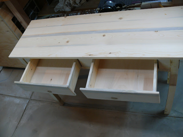

I’ve completed my Shaker-inspired Hall Table, out of beetle-kill pine:
Yep. A leg warped, after glue-up. Gonna’ live with it … at least for now ;-)
