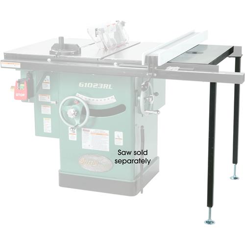

”Any others that anyone know of?”
Router-Extension-Table-for-Table-Saw/H7507

Scott, I had actually looked at that one also, just didn’t like the way the router mounted. I think all the others you actually screwed the router to a drop in plate, this one you clamped the router to the bottom of the table, it just looked like a lesser mount, but please someone correct me if I am wrong (not like its ever happened before or anything).

You’re correct that it mounts from the bottom. I don’t know if it’s a lesser mount…the upside is that it’s easy to mount and it’s more seamless, the downside is that it can’t be easily lifted in and out like a router plate can.

Yeah Scott, as my kids say, that looks like pretty weak sauce. I think I would rather have the plate type
