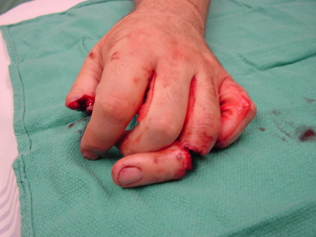

1635 posts in 412 days
51 days ago
Here’s what a left hand looks like after a split second of indescretion:
Any questions?
3538 posts in 609 days
51 days ago
That will make a few folks think twice in the shop today, Bob.
Glad I hadn’t had breakfast yet. <g>
51 days ago
Hey Guys:
Still thinK a the Grr- ripper is too expensive?

Bob,
That photo of the severed fingers bring me that much closer to deciding to save up for a Sawstop.
I watched the Charles Neil video on the Sawstop a few weeks ago. He said his accident was not the result of his doing anything incorrectly, but just happened. Never before or after. It happened in a split second. He said he ended up regaining 60% of the use of the hand after enduring months of rehab and extensive medical bills even with health insurance.
I know the Sawstop costs quite a bit more than comparably configured quality table saws. I just can’t get away from the fact that operating a table saw is inherently dangerous. Anything that would minimze the seriousness of any injury is worth strong consideration even at Sawstop prices. I am beginning to think of the added cost as added insurance.
Dalec
