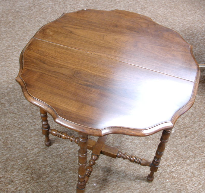

3808 posts in 2188 days
#12 posted 1875 days ago
Justin, It’s not the very best unit on the market but for run of the mill small jobs it pushes out a decent pattern and is not at all difficult to clean.
It makes a great starter gun to learn on.
Incidently, painting wood products is not nearly as demanding as spraying metals and plastics where every imperfection shows.
You can use the same vacuum cleaner/turbine motor and housing with a more accurate gun should you feel the need to upgrade the gun later on.
p.s. Try to keep the blower part a good distance from where you are spraying so it does’nt circulate paint aerosol into the filter and or turbine.
This is a pic of the first job I did with this gun:
