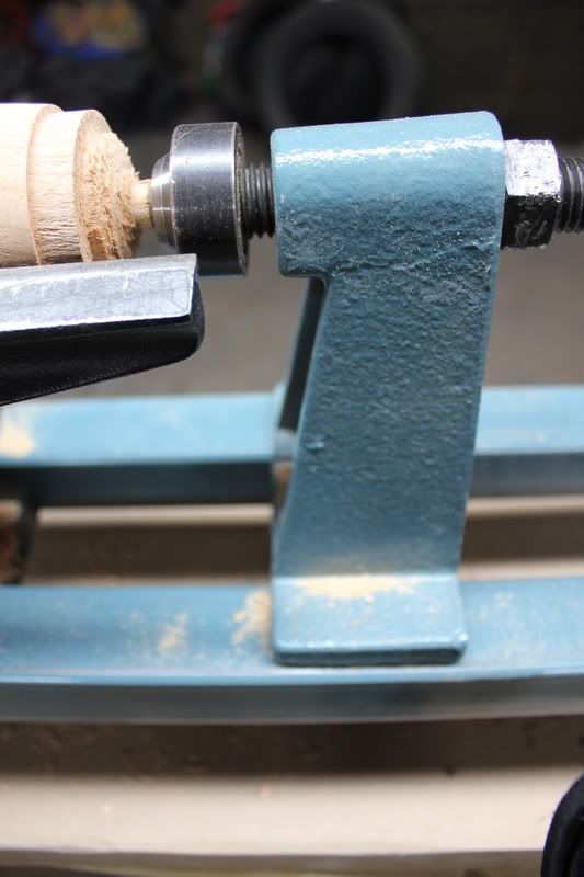

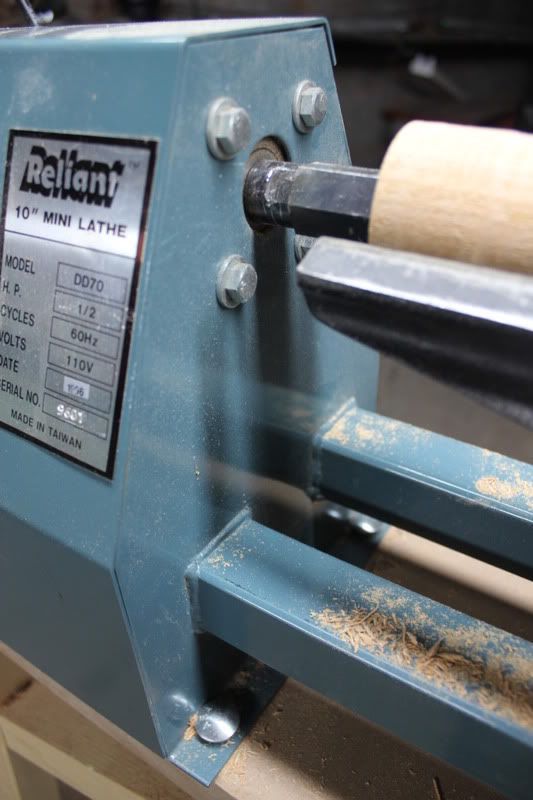

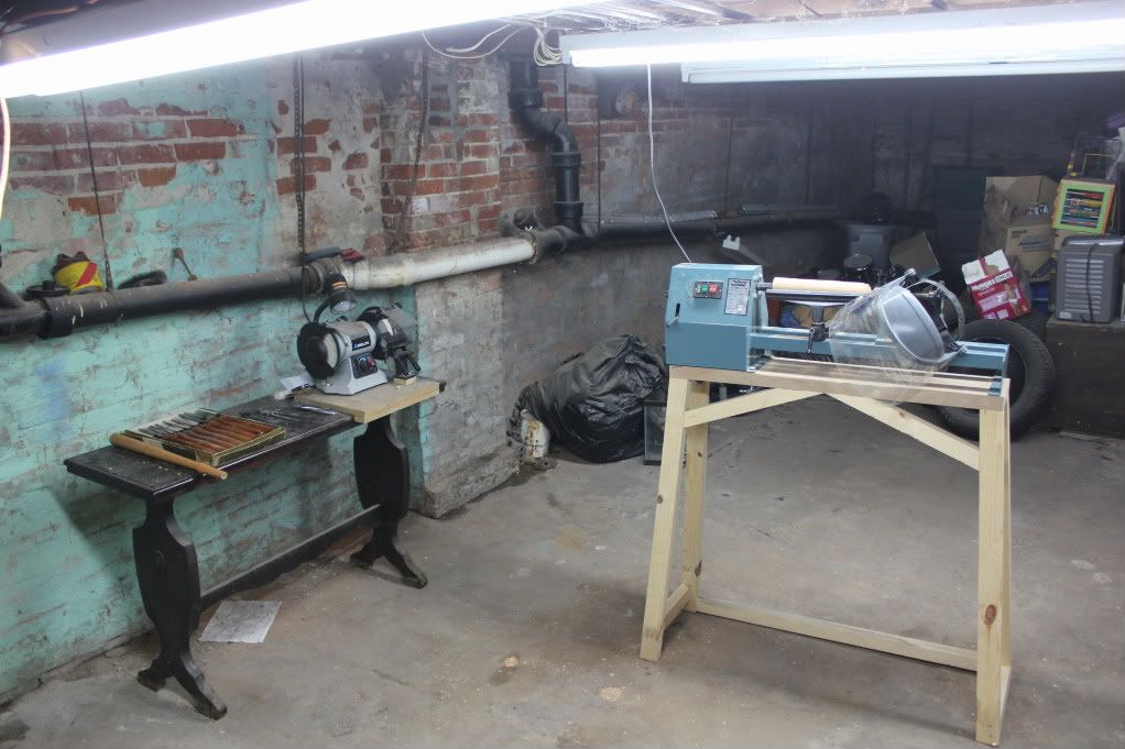

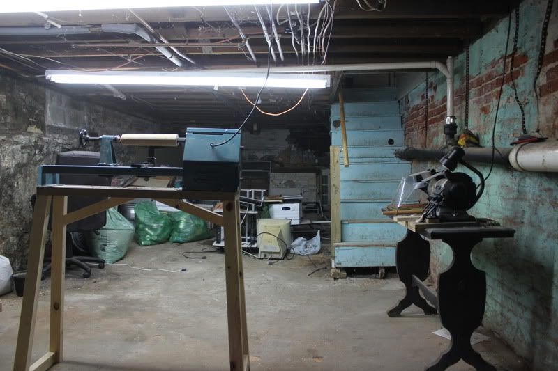

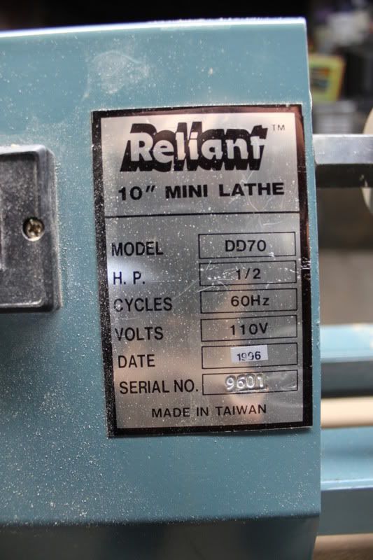

And as for posting pictures of my set up here they are I am in the basement of my apartment. You can see in the first and second picture a bigger thicker prototype of my stool leg. I had to set up the lights and run the wires that took forever just to get enough light down there. I also have a delta variable speed grinder set up with a higher grit wheel and a buffing wheel with white rouge(thinking I could polish the grind further but it didn’t really work so I use it for other things, I’ill probably set myself up like alan lacer does with an mdf wheel for further honing later on) In the fourth picture is the tail stock made of cast iron, it’s pretty solid so I don’t see that as a problem. The other thing I thought of when I was down there is that I have yet to install the lag bolts that hold down the tail stock end of the lathe, though the has never been an issue before so I don’t know if it’s part of the issue now or compounding it some how. Well there it is let me know what you think. P.S. I know the piece set up looks rough it was a piece that snapped under duress as I was yelling at it with a skew. : ) just kidding it was the result of quick and unskilled parting, I could have been careful and taken more time, but the conditions under which this ugly result was produced didn’t permit it.
The lathe you show in the pictures is a different brand name, but is the exact lathe I described before that I purchased at Harbour Freight. I’ll bet the bed tubes are bowing when you crank down on the stock. I wish I had an answer to the problem. Like I said before though, mine tore up before I found a solution.
