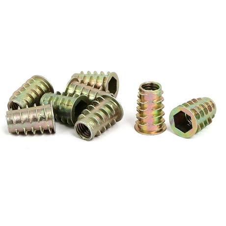

Unfortunately, he only anchored the table around the perimeter (no inserts or anchors down the center of the table), and he used what I’m going to call ‘crappy inserts’:
...and the table went concave again after the humidifier tent was removed. He wants to install more of the same inserts down the centerline, thinking that will fix it; I’m almost certain it will not:
  1. That type of insert is dependent upon small screws for holding strength; probably no match for what I expect will be hundreds, if not thousands of pounds of pulling force.
  2. Even if the inserts held, the strain would probably pop his biscuit joins like the seams of a suit too small for a large man.

I’m already flattening the slab again with the “humidifier tent + tile boxes” method described above. Once flat, I plan to seal the bottom with AnchorSeal or Lee Valley End Sealer for Logs and anchor the slab to the base down the middle with the largest ‘not-crappy threaded insert nuts’ I can find:

Are the inserts I plan on using the correct type? Possibly, but probably not. Even after the wood is dry, it will move with moisture change. The top has to be attached allowing it to move.
