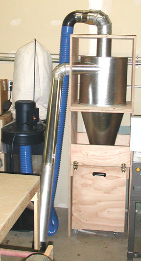

2057 posts in 550 days
262 days ago
I give mine a whack on the bag about once a week and the flour drops into the lower bag.
I find that the smallish cyclone separator I rigged up removes a lot of the material before it get to the bag too.

Bob, I would love to have a cyclone, but all I can manage is a 2-stage collector
Collection Box
The collection bin on the cyclones are too small – the box above has a 600 Cu Litre capacity (160 gallon), this is connected to 2×2HP single stage collectors – all the duct work is 6” and reduced to 4” or 5” as close to the machine as possible, usually within 3’
262 days ago
HI Tony:
Looks like you have real production going there. 600 lt. is a lot of space.
Do you fill it up quickly or did you design it for fewer changes?

When I made the 10 chairs, I recently posted, I half filled it, but when I made the Table (Not posted yet) I filled it. Most of the larger dust and chip particles stay in the box, about 99% of the dust stays in the plastic bags and the remaing 1 % (smaller than 30 micron) fills the atmosphere outside of the workshop.
But for normal run of the mill work, where there is not a lot of surface planing, then I guess about once every 6 weeks or so I check and clean the system out.
The reason I built it, was because I was tired of having to empty the plastic bags on the dust collector half way through a planing job – I also removed the collectors to outside – the noise reduction is so significant and the amount of fine dust has been dramatically reduced.
