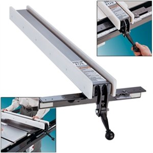

Like everything, which one you like best is going to be a matter of preference, but the Mulecab is no where near as stout as the SF, plus it needs to be slid off one end or the other to remove. I’d go with the SF in a heartbeat if the prices are remotely close.
I do think the SF “Aluma Classic” that Bill White mentioned is a better fit for your rig. Both have steel tubing but the SF “Classic” has bigger and heavier tubing.
SF Classic:
_
SF Aluma Classic:
