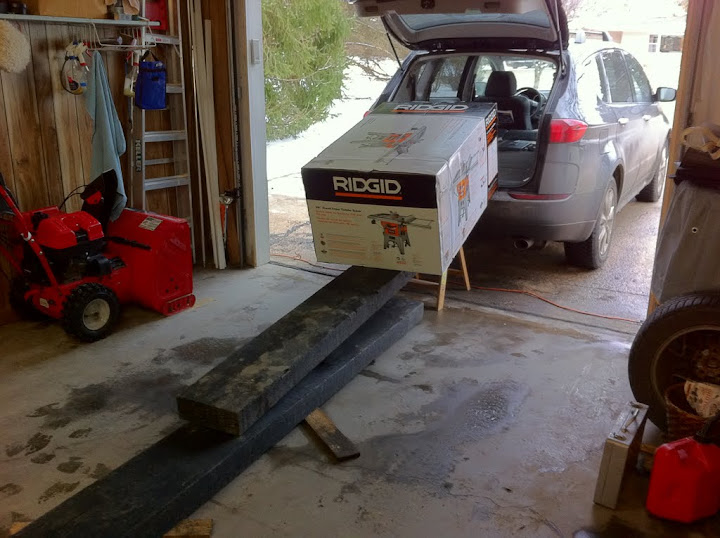

#15 posted 449 days ago
How to unload 280lbs by yourself.
