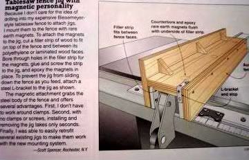

Here’s one. The captions are hard to make out in the pic. It’s an aux fence for a Biese type fence that uses rare earth magnets and an L-bracket to hold it in place instead of drilling.
