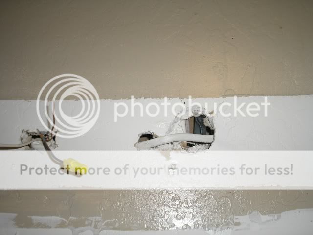

My wife and I bought a new home 6 years ago and after 6 months of construction we were ready to move in. The home is your cookie cutter tract home in a nice area of town. It is not the Taj Majal nor is it a single wide trailer with polyester curtains and the redwood deck either.
We decided that we would have the home built with contractor grade ccabinets, carpet, tile etc and live with that for a few years while the kids were young and the dogs were small. Well, the kids have grown up and left the nest and it is now time to remove some of the builder grade amenities.
The first of the upgrades is the flooring. The chocolate brown carpet is gone in favor of travertine and hardwood. After talking it over with the LOML we choose to replace the vanity and sink in the second bathroom. I removed the vanity, sink, tile and mirror. The mirror was glued and with a little persuasion and luck it came off but did damage the drywall in the process. Next I turned my attention to the crappy light fixture above the mirror. I removed the outer cover on the light bar and noticed the wiring looked funny. I did not see an electrical box in the wall behind the fixture. I figured the drywall crew covered it. The electrician mounted the bar by screwing through the light base plate into the wall studs, one thing for sure the light was not going to fall off the wall. I cut the power, removed the wire nuts and 4 drywall screws tha held the light in place. To my surprise this is what I found.
I about fell off the step stool!! The electrician did not install a box at all and during the rough in ran the wiring in the same stud bay with the water lines for the vanity!! Are you serious!! To make matters worse the wiring was run over the top of the stud to the light. They did not drill a hole in the stud for the wiring and to make problems worse when the light was installed a mounting screw pierced the romex. What a *&^#$ moron!!
While contemplating how I was going to handle this repair I took a short break and considered calling the city and builder to voice my displeasure. I thought it was better to leave well enough alone and just fix it. Fixing would require a larger hole so I set about cutting the drywall. At about half way through the cut between the studs I fit some resistance, so I stopped. Its the vent pipe for the sink, right in the middle of the bay! I finished cutting and removed the drywall and I now know why it was wired like it was. The plummer did his rough in before the electrician and ran the vent for the sink right smack in the middle of the studs. There is not enough room to mount a box. My next course of action is to move the vent and gain some room for a box. Off to the bog box store, again!!

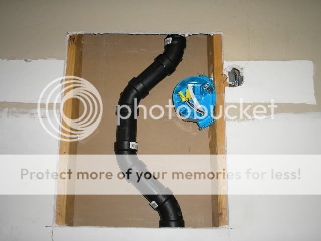

I cut the vent and installed a new electrical box, drilled a hole through the stud and mounted a nail plate over the stud to protect the wiring. With a few short pieces of ABS and some 45’s moved the vent out of the way.
Seeing crappy work like this makes me wonder how the rest of my house is wired? I am just glad we didnt have a fire.

Please call your city, the builder, and maybe even a good real estate lawyer, but definitely the first two, and take the information you found to them.
Shut down shoddy building practices like this and you might very well save a life.

You’re still not right you electrical box should be on the other side of the stud completely away from the pipe even if it is a vent, a vent pipe gets humidity and does not mix with electricity.

Now, as far as the wire over the stud, yes that is a definite code violation and as such is suppose to have a nailer (metal plate) over-it. I see this most of the time when a house has been remodeled and removing an entire wall just to add one circuit would be way to cost prohibitive. By the way, its legal as long as there is a nailer covering it.
And finally, Building codes specify that you are not to have a vent pipe and a circuit box in the same stud bay, SO, your fix, in itself is a code violation.

CampD…...I am aware of the box and vent being an issue. But tell me this, if I were to install it on the other side of the stud there are the supply lines for the vanity and toilet. I feel this is the lesser of 2 evils.

As I mentioned, a vanity light can act as its own box.
“Edit after gary’s post”
Yes, The light fixture has to have a metal back plate (box) and most (I say most, as Home Cheapo’s may not)and bath vanity lights are designed with the location that they will be installed in in mind. Wall Sconces are different item and the backer is left off to keep the cost down and in that case a pancake box is the most likely choice for mounting.
Now, back to the OP. I see in the pick that the light bar that was in place covered both stud bays and (I will blame the electrician, or who ever installed the light bar) that they could have easily accessed the light without crossing over the stud, which is the only violation.
And before you call the electrician a moron, your fix has numerous code violations!

Having been in new construction and remodeling, both commercial and residential, what you have found and the other LJ’s stories are only the tip of the iceberg. I find code violations all the time in new homes as well as old.
As canadianchips mentioned, even home inspections are no where near perfect. It would be impossible, from a time stand point, to be able to dismantle every fixture to check behind it. Unfortunately these poor work practices, as hazardous as they may be, are not discovered until a renovation is in progress.
As far as I know it depends on the electrical fixture being mounted on whether a box is required or not. If the fixture, such as a bar light, is enclosed then the wire can be connected inside the fixture. If it has an open back such as a sconce, then a box is required. As far as crossing over the stud, that was just plain poor planning on the fixture placement and somebody screwed up royally by crossing over the surface of that stud. Wiring passing through a framing member needs to be at least 1 1/4” from the edge of the framing.
I’m glad you did discover this poor work so it can be corrected properly and avoid a future disaster. It’s depressing when you find it but relieving when it’s repaired.
I don’t even want to get started about inspectors that don’t do their jobs….eehhhh
Edit: As CampD mentioned about the stud bay violation, this is just poor planning on the plumbers part. A good plumber would not run his vent by the center of the vanity location. They would realize a fixture may be located there. Also falls on the builder because he should be orchestrating alll of this.
