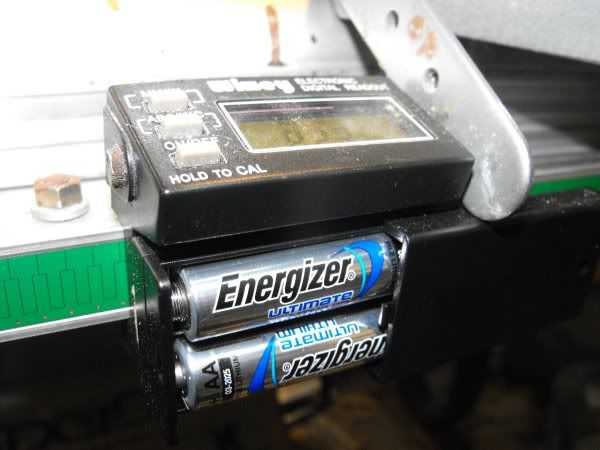

Its finally coolong down here in North Florida, so I am able to start getting back into my shop and start working and solving some of the things that bug me in the shop. I love my wixey products, but i dont know if its just mine or what, but the readout for my table saw ate batteries. A new set would last less than a month… even when it was off. I came across a battery box at Radio Shack that held 2 AA batteries. This was perfect because the wixey “watch” battery was a 3 volt cell, 2 AA batteries = 3 volt. I soldered the battery leads from the box to the terminals inside the readout’s battery compartment. I then attached the box right to the front of the readout with some double sided tape. So far it works great, the batteries last much longer, and 2 AA batteries are cheaper than the cr2032 battery that it orginally took.

I have had my Wixey for about 8 mos now. I have never had to change the battery in it. Once I had to take it out and re-seat it because sawdust (where would that come from!) probably got in there. I’m not sure why your battery keeps dying… ????

I dont know… I own most of the products Wixey has, Ive had 2 of these saw readouts, and both of them eat batteries. All the other wixey products last over a year on one set of batteries.
