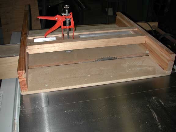

How long is the wood you are cutting?
I have used my crosscut sled (24”) for this cut as I built it with a vertical hold down so there is little risk of tossing the stick out from under it.
The base is Mdf and I just glue in a new strip of it to close the gap from the bevel when I’m done.
p.s. it’s not an everyday event here BTW.

2055 posts in 549 days
280 days ago
Yesterday and in direct conflict with my preceding statement I made up a 45° bevel crosscut sled.
It is similar to the one shown above and uses the same hold down to avoid more clutter.
My joints are dead on with this jig and you cant put a hair in the line between the parts.
If only for accuracy I would build this but the safety is unchallengable.
In esscence this does move the wood to the left of the blade.
