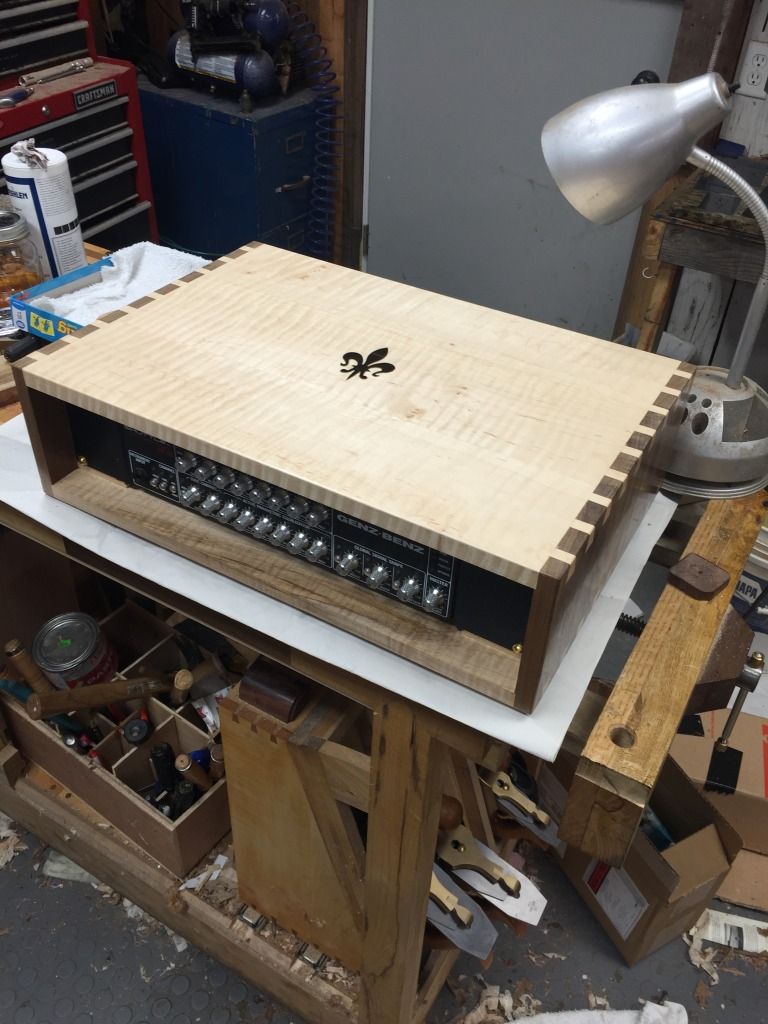

And in case you’re interested, here’s one example of one of my amps from a while back. This one was done with a cheap Harbor Freight jig. The little grill snag got repaired.

That’s pretty sick.
Yep, any glue surface with the grain will be stronger than the wood.
One I made for myself. Incomplete.
