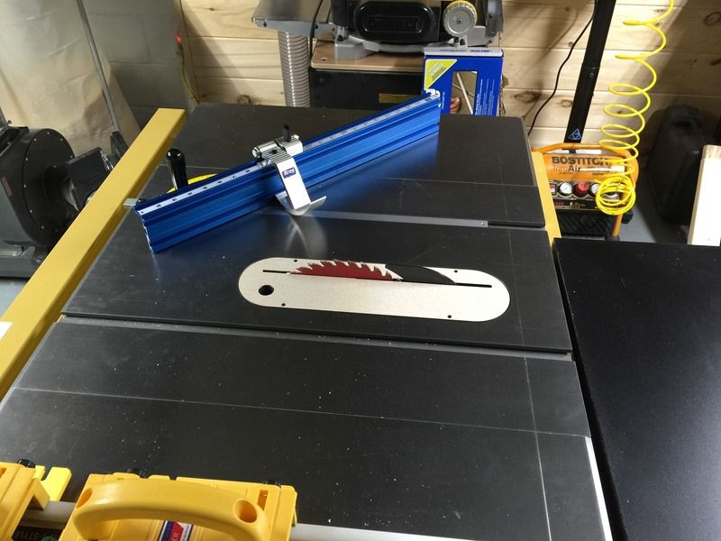

View ScottM's profile
ScottM
691 posts in 2346 days
#5 posted 08-10-2016 01:55 PM
I just ordered the Incra 1000HD yesterday! Just got tired of fighting a losing battle with a wobbly miter gauge that won’t stay fixed at the set angle. Interested in the opinions as well.
