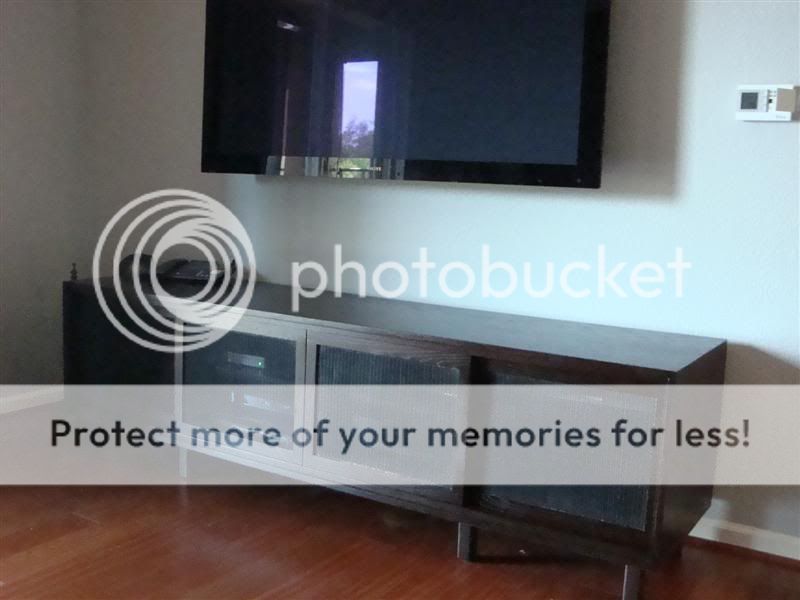

I built this cabinet for a customer last year and after some minor disagreement with the customer added the legs toward the center of the cabinet.
It’s slightly over seven feet long and packed full of electronic components – some of them pretty heavy. The original plan just had legs at the ends, but after building it (and seeing her pile of components), I insisted on adding support.
Depending on the overall length of your cabinet, and the weight of the “stuff” you’ll put in and on it, some kind of center support might be a good plan.
