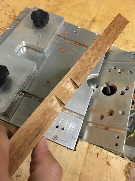

Hello, Fellow Woodworkers.
My name is Jack Colliflower, and I make products for wood workers (namely zero-clearance plates for table and miter saws).
I have a new product which I’d like some feedback about. I’m going to attach some pics and a video link.
It’s not for sale now, but I’d like to put it on the market soon.
Mainly, I have my experience and the opinion of some great wood workers. But I’d like some more opinions. I am a machinist first and wood worker second (I’m looking forward to the time it will be the other way around :)
It’s a router table/plate that is installed similarly to a router plate which is put in a table top.
It can be used traditionally (like any router table), but it has a fence which functions as a sliding table; it can tilt zero to ninety and lock into position; and in that position, it can slide back and forth. It can accomplish angles that, otherwise, would be quite difficult.
Attached are pics. Please ask if there are any questions.
Patent-pending.
Jack Colliflower
PS: There was some sort of problem with loading the pics, so here is the video link and I’ll work on the photos: www.youtube.com/watch?v=wnWlmNviM0s
-- J Colliflower

View Jack Colliflower's profile
Jack Colliflower
51 posts in 2335 days
#8 posted 02-22-2016 10:36 PM
Trying again for pics….
Here are a couple of cuts which would be really tough to make on a “regular” router table.
(I’m not saying these cuts are particularly useful—just showing some capabilities.)
Jack
-- J Colliflower
Jack Colliflower
#10 posted 02-23-2016 03:21 AM
Thanks for your opinion. I have contacted some of the “biggies” to see if they’re interested. We’ll see….
