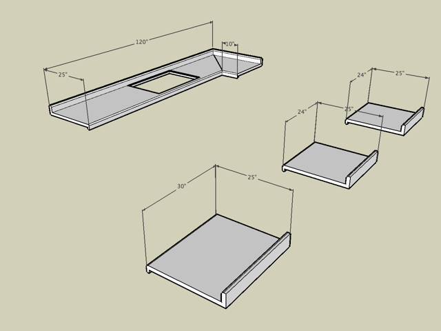

Ok, here it is.
In any case, all 4 tops are 25” total depth, with a 3/4” front deep front lip, and a 1-1/4” backstop. The diagonal line in the L shape is a real seam in the current setup. The hole is the sink. In between the freestanders on the opposite side are the range (30”) and the fridge (~40”). In the current setup, everything is laminate. For my own work, I’m guessing that using wood trim for the lip and backstop will be simpler (and possibly better looking), although that may prove unacceptable, because all of the current cabinetry is (badly) painted white, and there is blue wainscoting around the kitchen that comes just under the top of the backstop. Ok, done rambling, here it is:

12887 posts in 881 days
334 days ago
Ben from your design go for a wider piece for the corner so you don’t have to put in a “V” It will just be one piece. It looks like its about 35” wide across the “L” shaped piece. Make that all one piece.

Ben the way you are drawing this is like Lowes boughten counter top. I use a layer of 5/8 inch particle board and top it with a layer of 3/4 inch particle board, glued together with yellow glue and braded. After the wooden edge band(1 1/2 inch high) we fill the top joints with filler and sand when dry. The laminate is applied with contact cement and applied about 1/2 inch wider than the finished top. The edge is then trimed with a laminate edger. The backsplash is applied on top of the counter after the laminate and sealed with silcone.The edge is finished after laminate and the backsplash before. We fit the sink before we laminate and then cut out the laminate. Be sure you under stand how to use the contact cement. I just read your post. wholesale Formica is about $1.80 sq.ft. so $3.60 would be about normal retail. You will need a laminate roller. It calls for 45 pounds per square inch.

5X10 would work if your 120” measurement is right. Do you have a crown type detail on your cabinets. If you can use a wood trim at the crown it would help a wood front band and back splash blend with the painted doors.
